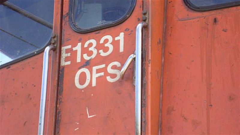

Wheel spin damage by E1331 OFS ???
PietConradie
- Posts: 25
- Joined: 19 Apr 2009, 21:14

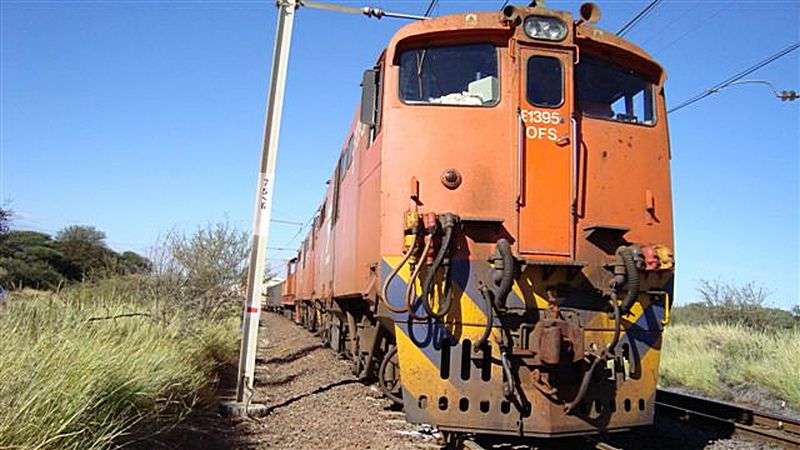

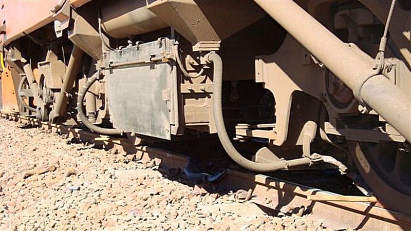

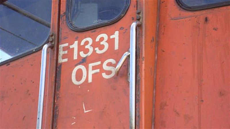

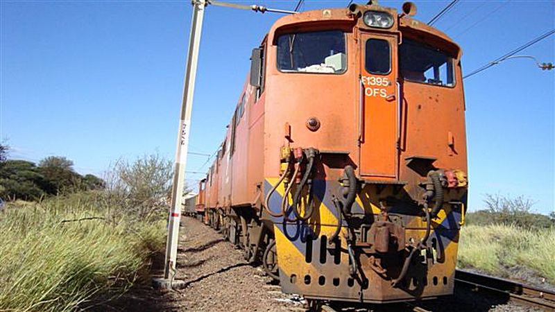

I have received these pictures as a "FORWARD" via email - no details about the incident or the unknown photographer - the pictures appear to be authentic.
The photos are likely to have been taken by the repair team.
The 1st picture was taken at 10h04 on 4 May 2009 and the last one at 12h53 the same day.
Has anybody more details on this incident, and how (un)common is this?

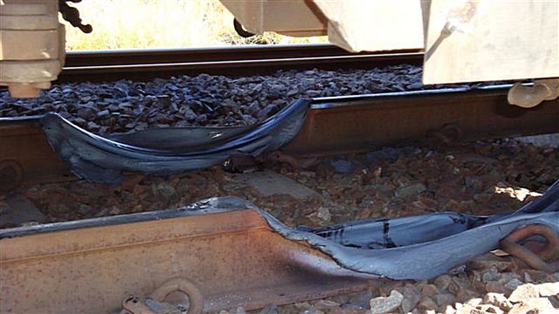

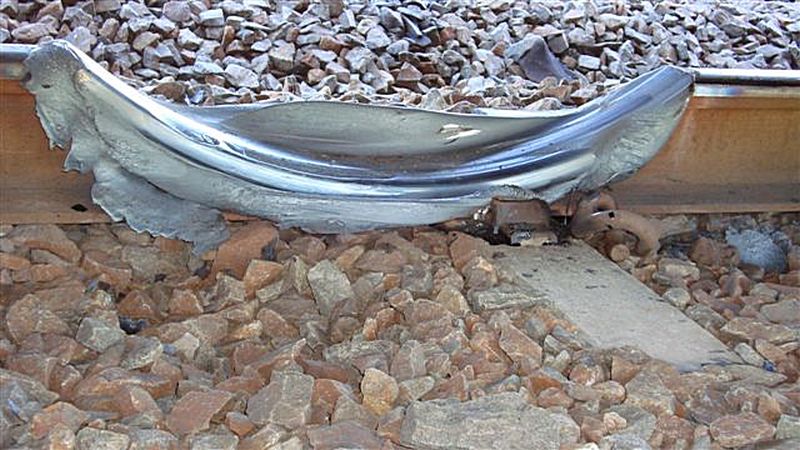

- time 11h24:51
- DSC00058.jpg (45.71 KiB) Viewed 10015 times
- time 11h24:39
- DSC00057.jpg (45.85 KiB) Viewed 10013 times

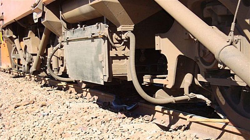

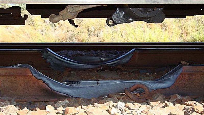

- time 11h18
clearly a section of the rail has been removed - DSC00052.jpg (86.12 KiB) Viewed 10012 times

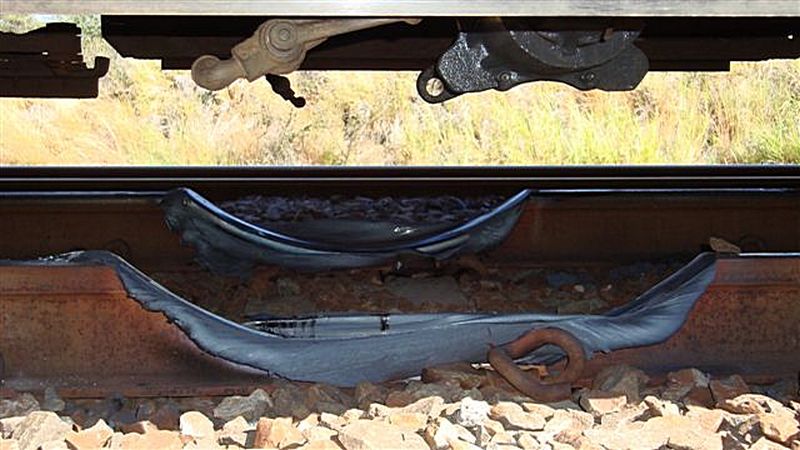

Re: Wheel spin damage by E1331 OFS ???
My first reaction was these are fake! But I have looked at the pictures very carefully and they appear to be genuine - or really superb fakes - but I really do not think the latter as there seems little point in going to all the effort this would have taken.
Which leaves me gobsmacked.........! And still a bit unconvinced!
How does something likke this happen? Is it really that feasible? Is the melting point of the wheels higher then the track by such a large degree?

I have to admit I am also puzzled, of interest is that both tracks are affected, so whatever went wobbly was on that axle. I dont know anything about how these things are powered but that wheel was either going really fast and everything else was going nowhere, or that axle was the only part doing anything and the loco couldnt get going. What puzzles me though is how much damage was done, surely at one point the axle wasnt touching the rails any longer? how hot must steel get before that sort of damage happens? It will be interesting to find out what happened, this cant just be some cowboy popping wheelies.

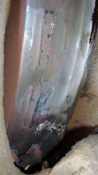

So I am also guessing and maybe the experts could help answering questions like:
(1) Would the steel used on the tyres of the driving wheels of the loco have a higher melt point - after all these "tyres" have to grip the rails all the time to move the train, so one would expect the "tyres" to be of a higher grade steel than the rails below.
(2) If one set of driver wheels on the loco was doing a wheel spin, the rail below the set of wheels would endure continuous friction at the contact point, while the driver wheel itself has the friction & heat spread around the wheel's circumference - might help explain the one-way results a bit. I also imagine that the driver motor and wheels as a group lower themselves automatically as the rails melted away, causing further damage ... again the experts have to give their views.
(3) I would dearly like to know how long it actually took to cause all this damage? A matter of seconds or much longer? And why could the loco driver not remove power to the wheels earlier? Did something got stuck?
(4) I have picked up that some locomotives are fitted with wheel spin control making them more economical top run - would the locomotive in question be fitted with such controls?
(5) Maybe someone can still prove or report that it's all a nasty fake. Then I shall apologise right away for wasting the time of the good Friends on the forum!!!

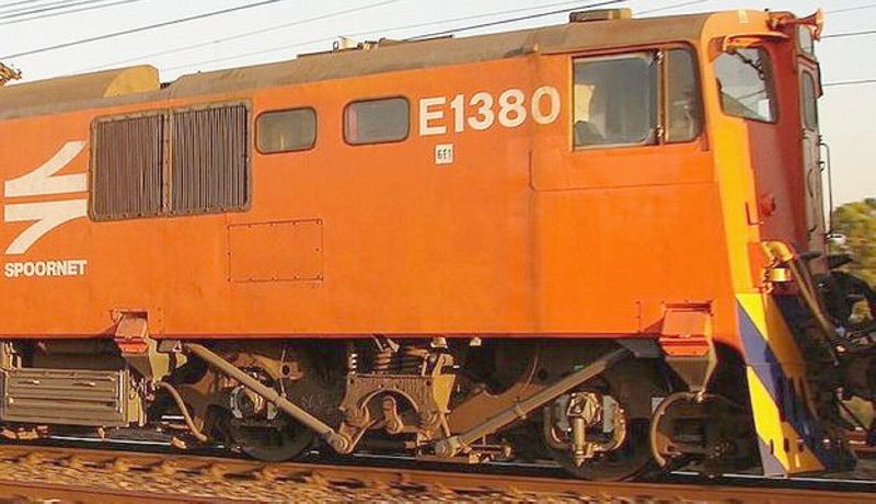

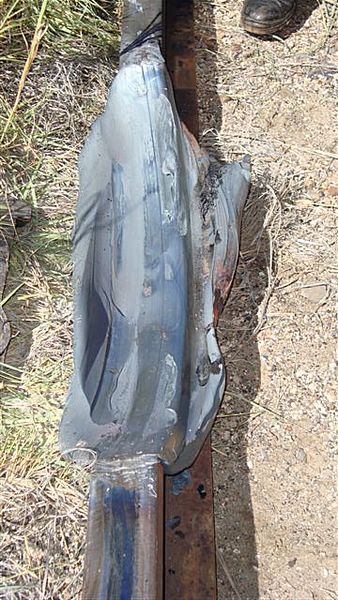

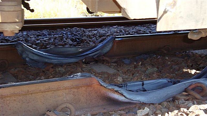

I vote for fake for several reasons:
1 - I would guess that it would be impossible for only one axle to spin for long enough to cause this extensive damage happen without the driver intervening.
2 - The rail in picture 4, while the damage looks similar, is not in the same setting - compare grass and ballast.
3 - The locomotive numbers are not the same in the two pictures.
Tom Macrery
- Posts: 308
- Joined: 26 Jan 2007, 08:47
Revision to my point 2 above - Yes, I see that the section of rail could have been removed. But could it have been removed in the short time between the two pictures - just over an hour. And would the two sections of rail have been removed and a new rail temporarily welded in place in order to move the train?
Added Point 4 - The odd circumstances surrounding the receipt of these photos by Piet - no details, a "forwarded" email (often hoaxes), no dates, no place.

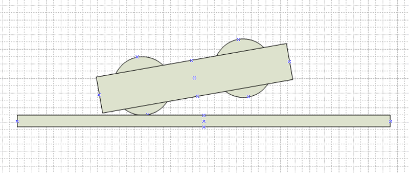

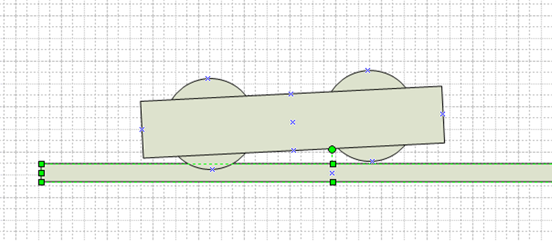

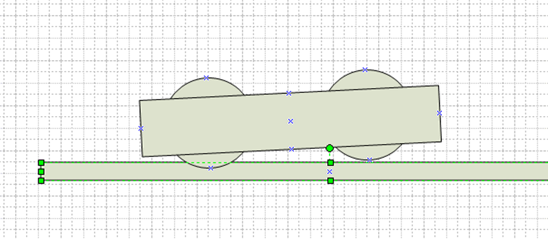

Question - When the wheels stopped spinning and were then sitting in the depressions of the rails, how would the train have been moved? Jacking? Towing? Pinching?
I have the same question as the one Tom ended with. I am currently trying to work backwards in the chain to trace the source of the email. Don't hold your breath yet!
How much can one gather from these pictures? I still notice more details when taking another look.

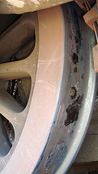

(1) I think the problem was caused by the 2nd loco in the consist. That one was probably E1331. If one looks from the front of the consist (5th pic "23.jpg") and compare with the next (6th pic "22.jpg") I would say that the visible features best match that of the 2nd loco.
(2) The 2nd picture ("58.jpg") shows fresh oil leaks from the motor casing of the unit behind the driving wheels -- note evidence of leaking oil on the damaged rail section in the last and 3rd last photos. Would that be reason enough to believe the driver wheel with the oil tears had once been over the damaged pit before the photo sequence were taken?
(3) Has anyone noticed the little wedges (each on the end of a wooden handle) placed behind the wheels - visible in the 6th photo ("22.jpg").
(4) On the aside, diamond (dust) wheels are used to cut diamonds, so I guess in the same way steel could cut steel.

I think the little wedges may be for the sand spreading system. The pipe goes upwards to the sandbox. My gut instinct says these arent faked, I have fiddled with images myself and tried a stack of things, and these dont have the faked feel about them. Bigger pics examined at pixel level would reveal tampering at any rate. Where are all our electric loco drivers when we need them???

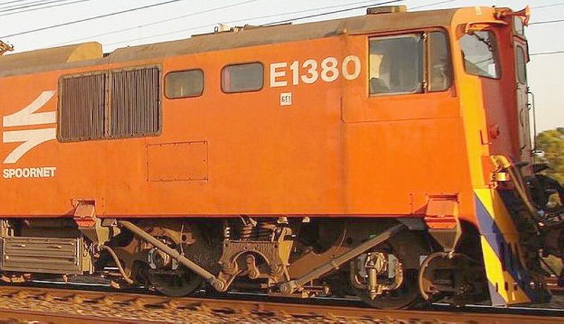

Apparently loco no E1331 is a member of the Class 6E1. Paxton & Bourne's 1985 Locomotive Guide states that each axle-mounted motor in these units has a continuous power output of 550kW, giving a total continuous power output of 2200kW per loco. The publication notes: "The successful application of this new generation motors required careful mechanical design to ensure maximum transfer of power to the rails without causing the wheels to slip" The Class 6E1 has a sophisticated series of traction links, clearly visible (also seen in one of the photos DSC00022.jpg above) on the outside of the bogie to optimize this function.
The class 6E1 has electronic wheel-slip detection, but in 1982 two Class 6E1's were equipped with microprocessors to test modern computerized methods of propulsion control. In 1985 the Class 6E1's was the most numerous single class of locomotive which then consisted of 859 loco's.
FICTIONAL SCENARIO: As a total layman I propose a possible scenario for the happenings - a total guess - and it would still be nice to get the real facts: The consist of 4? 6E1's, with train in tow, creeped up very slight incline (fact supported by wedges placed later on the "backsides" only of driver wheels - seen in one of the pics DSC00022.jpg above). The train was approaching a red signal, and the driver was hoping that the signal would turn green - finally the train was held at a standstill by applying just enough power to prevent the train from moving backwards again. At this point, wheel slip occurred on an axle under one of the units further back in the consist, but the driver failed to recognize the seriousness of the noise, or the noise was masked by other working noises, such as the cooler fans and other equipment. Although these units are fitted with wheel slip detection, this function clearly failed on this occasion.
Interesting so far.I am more suspicious this bright Monday morning!

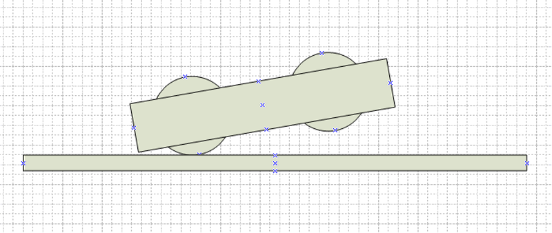

Something that has been worrying me is why is only the one wheel area scooped out?
The bogie has more then one powered wheel - both axles are powered, so there should be a similar scoop in front. So why not more "scoops"?
And in any event even if only the one axle was powered for some reason, how would only one axle sink? The axle is on a bogie and the bogies will not flex laterally to that degree - aside from the fact that the other parts of the bogie would prevent the sink by contacting the rail if the bogie was tilted at an angle - I am talking here about the frame etc that projects at either end of the bogie.etc. See picture one below.
And if for some reason the bogie did tilt and the wheel sink, surely given that the degree of tilt would be be within a reasonable degree, the depth that the wheel had sunk to would not be feasible. The second picture shows this and the tilt here is exaggerated too - in reality at this degree the bogie would be contacting the underframe and there would be visibler damage to the latter.

Kevin, I like the angle (no pun!!!) you are taking. I think it is a very valid point and certainly not easy to answer. One would like to see a picture of a complete bogie in the workshop.
From my understanding there is a 550kW motor on each axle (Paxton) and they (4 motors) work independently, so I imagine one axle could slip while the others are still maintaining grip.
I have searched for a side-on picture of these complex bogies - I get the impression that they are indeed flexible to a certain extent - designed to maximize traction of all 4 wheels under the bogie.
I have cropped a photo of a 6E1 loco taken by Andre Kritzinger and which he has posted here:
http://grela.rrpicturearchives.net/show ... id=1512497
This gives some idea of the bogie construction.
However, for me, this picture does not answer Kevin's question - it still looks like some part of the underframe should be damaged. Unfortunately we do not have all the photos of the incident. :(
