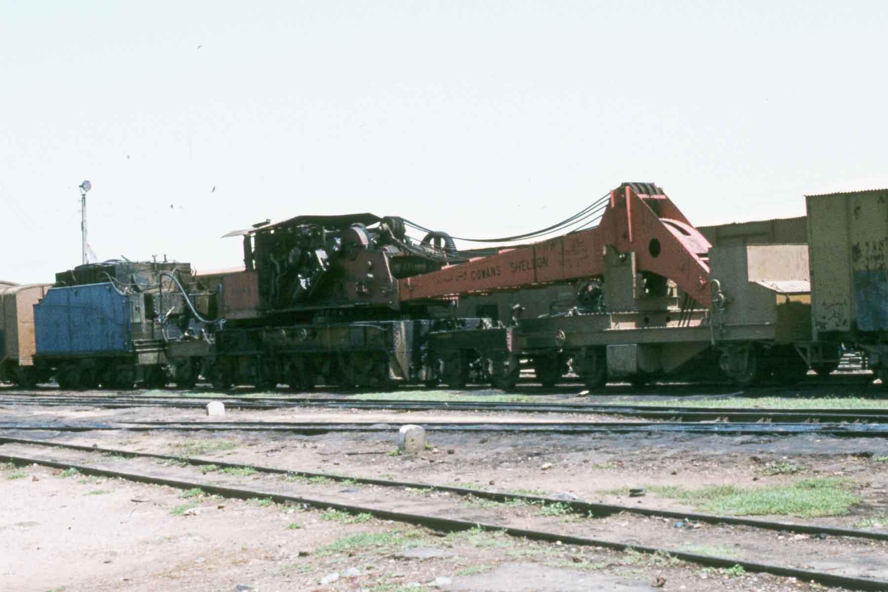

My thanks to Chris Capewell for the list and for sending me the photos. The first two are by Alan Clothier; the photographer is unknown for the third, but if he sees it and lets us know we will be happy to credit him or remove it.

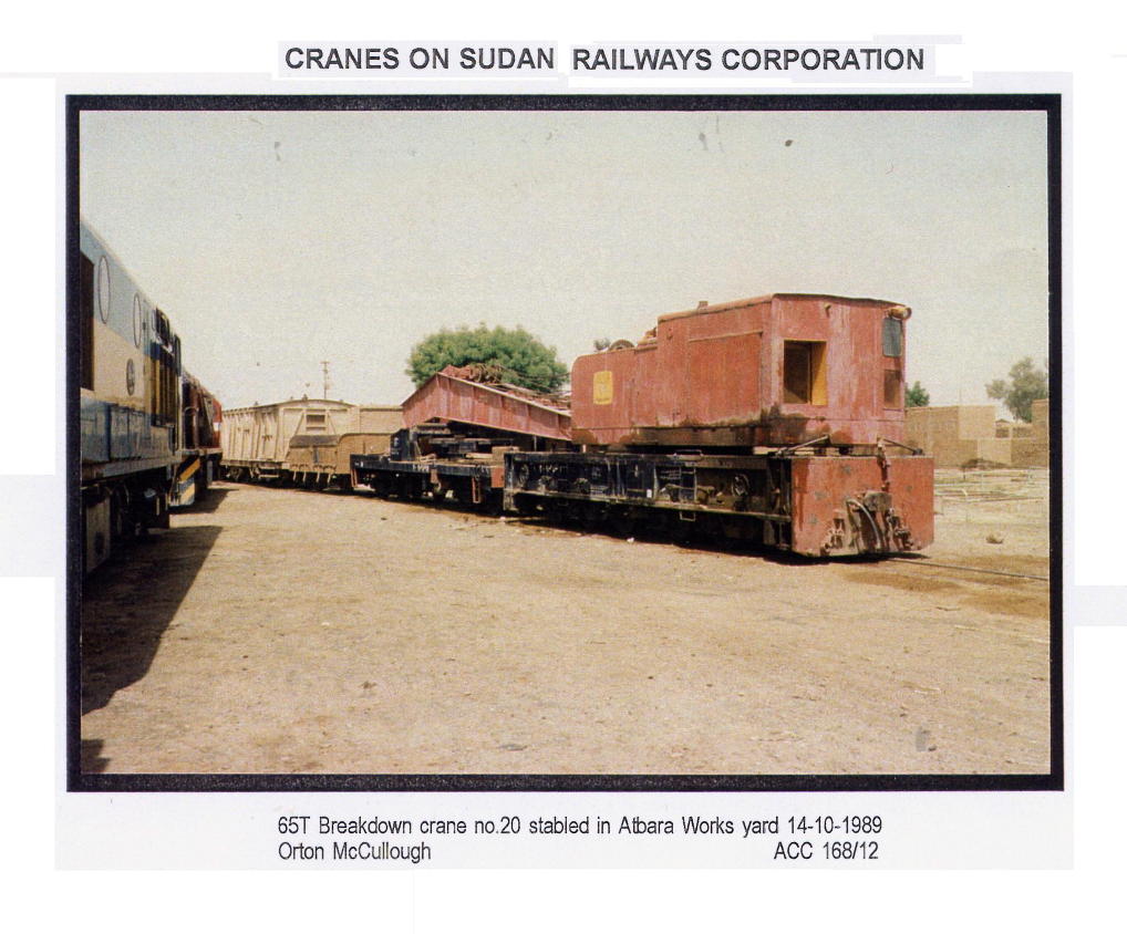

20 Sudan Rlys 3'6" DE 65T 6+6W Orton McCullough
Photo – Atbara 10-1989, c. A.Clothier.

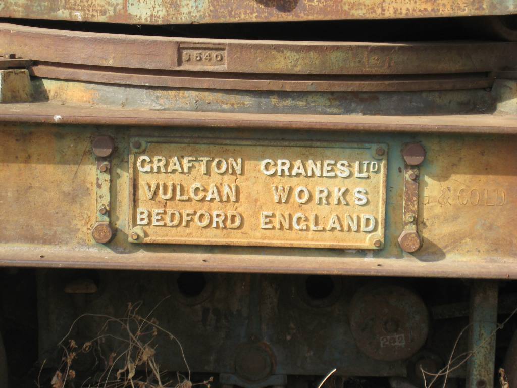

-?- Sudan Govt. ?3'6" ?S 5T 4W G 2993/1961
Scan – Juba, dumped 2007

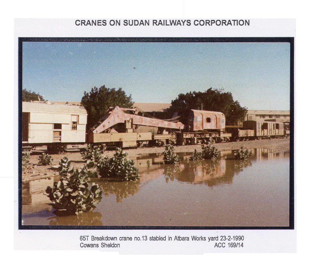

Sudan CS crane_s.jpg (134.12 KiB) Viewed 8264 times
Sudan Orton crane_s.jpg (122.01 KiB) Viewed 8264 times

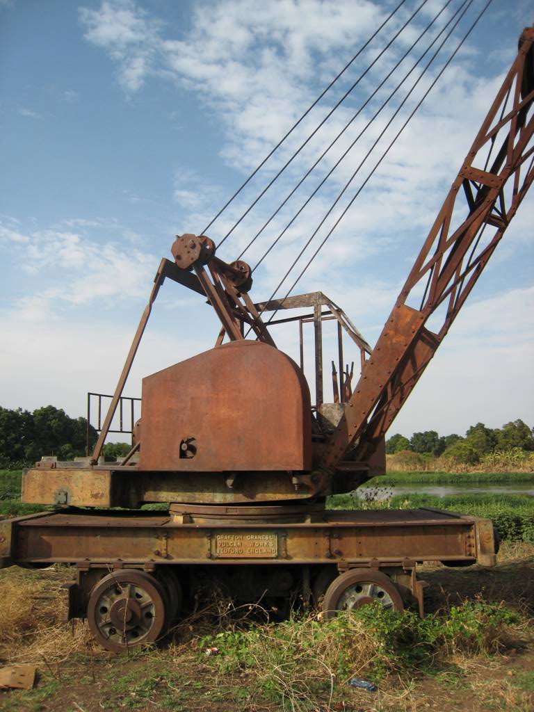

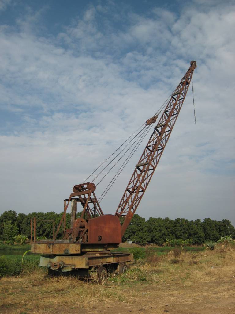

Nick McWilliams wrote:Hello Chris,
I happened to come across your page "Surviving Railway Cranes in
Africa". I am not at all knowledgeable about such matters, but I was
working in Juba, South Sudan, a few years ago (2007), and I am always
intrigued by signs of former times that I stumble upon around Africa.
In this case I was looking around the old port area on the Nile and
took some photos of a rail-mounted crane. I imagine it was once
adjacent to river, to lift loads from the Nile barges which travelled
from northern Sudan, but siltation on the river has moved the bank.
Attached are low-res versions, but if they're of interest, I can send
the original resolution pictures. You are welcome to use these on your
webpage (http://www.internationalsteam.co.uk/cra ... africa.htm)
I'll be interested to hear any comments from you.
Thanks and best wishes,
Nick.
PS the last photo is just for interest, what I guess it is an old
Bedford, which was sitting nearby, and like many others, still in use.
IMG_0251_70pc_juba_crane _makers_plate.jpg (102 KiB) Viewed 8252 times

Chris wrote:As I suspected he had misread 12 and 13 - so firstly the photo is of 12, and secondly any reference to 13 in the list can be deleted, as can the note re 'another' report.

Nick McWilliams has given me another link which goes straight to his crane pictures online: http://www.internationalsteam.co.uk/cra ... th%20Sudan
