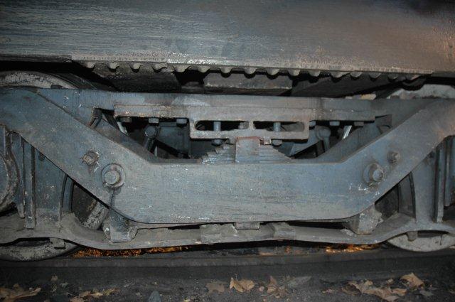

View looking to front showing compensating beam and blowdown cock.

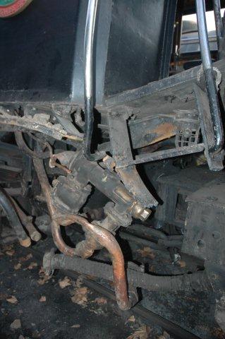

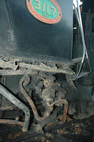

Damage to Fireman's side injector

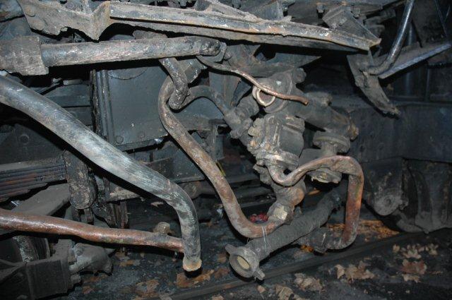

General view of Fireman's side injector.
Damage to cab floor, steps and injector.

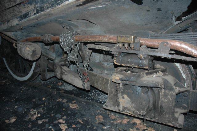

Damage to Fireman's side tender leading bogey

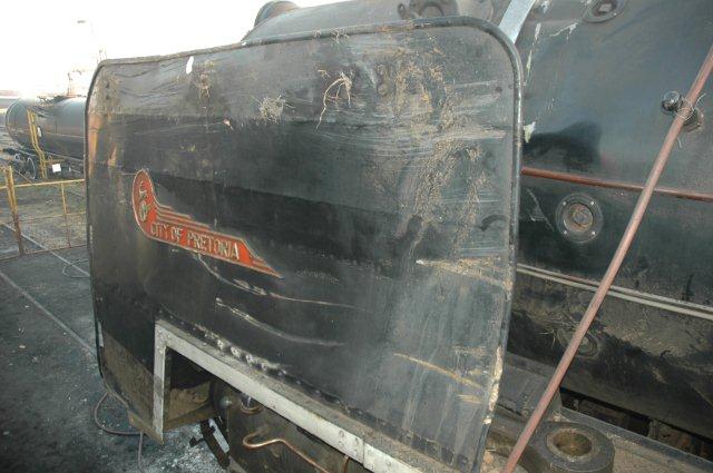

Smoke deflector
Smoke deflector

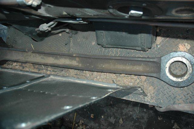

Bent fireman's side connecting rod.

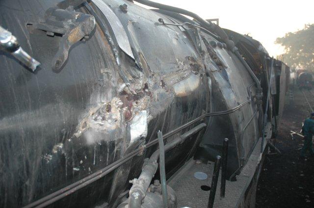

View from running board on fireman's side showing damage to regulator rod area. The rod had been removed at this stage.

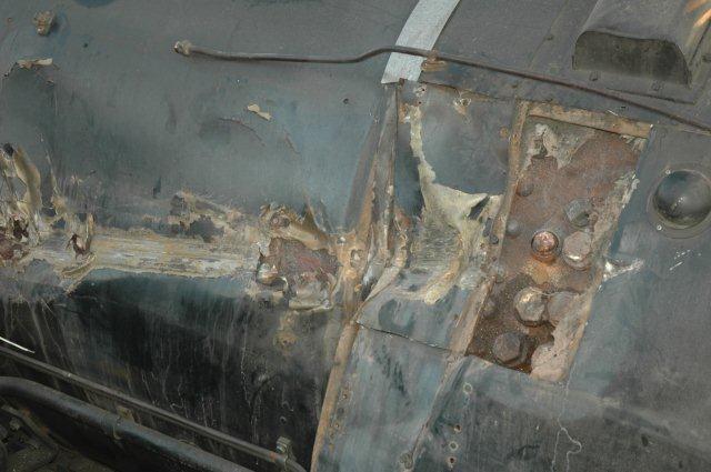

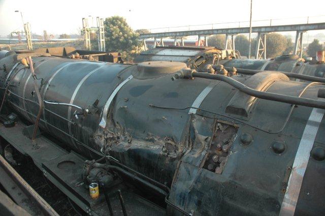

Fireman's side view of damage to boiler lagging and there is damage to a few of the flexible stays that can be seen at the open section of the lagging
Closer view of stay caps damage.
