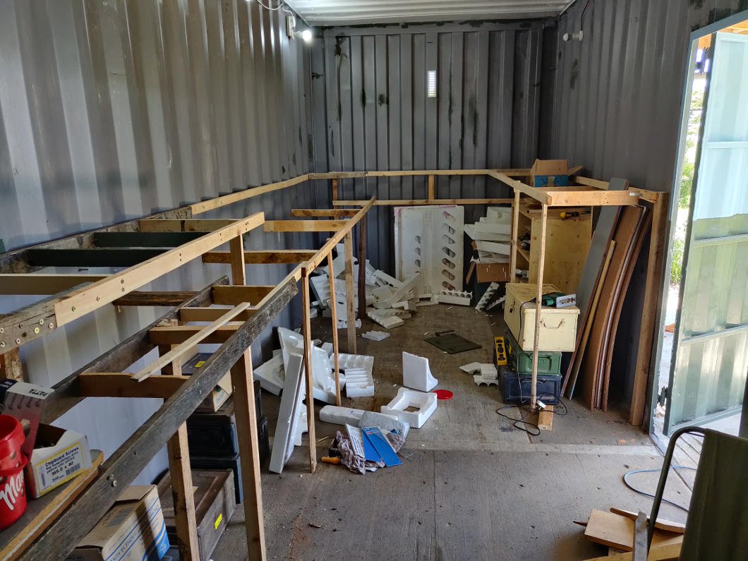

For several months now, on and off, I've been expanding the framework for the base board, a boring job since I'm no carpenter and don't particularly enjoy carpentry, but it has to be done. The place is a bit of a mess, with loads of foam polystyrene lying around, which we will eventually use for scenery. But I did manage to get the missus to help a bit with the carpentry.

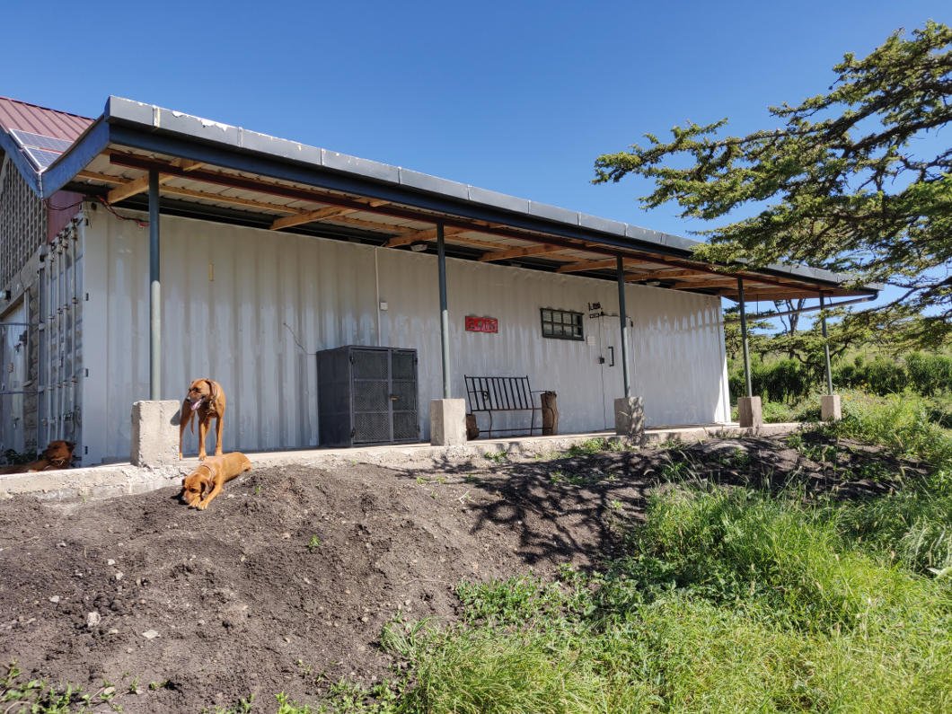

We've also been improving the general ambience, building a verandah to keep the afternoon sun off the walls of the shipping container in which the model railway is being built, putting a door and window in the side, and a few other small things.

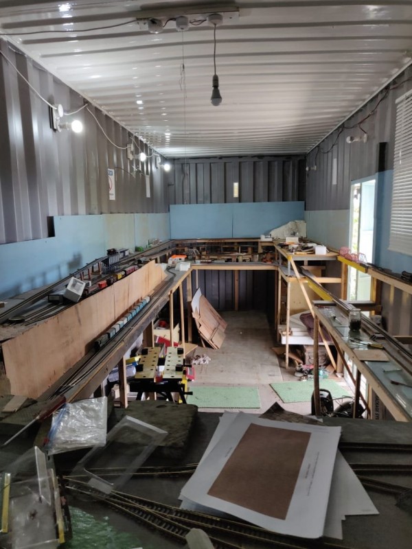

More progress on the baseboards. The bottom left will be the river area, and the upper level baseboard on the opposite wall will be the coaling stage and ash pit. The lower level will be an unmanned passing loop.

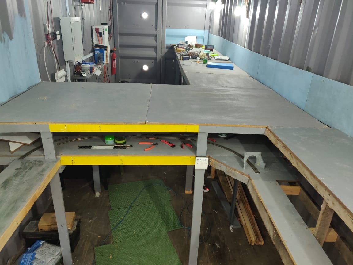

I've now laid the baseboards for the station (farthest from the camera) and the loco depot (in the middle).

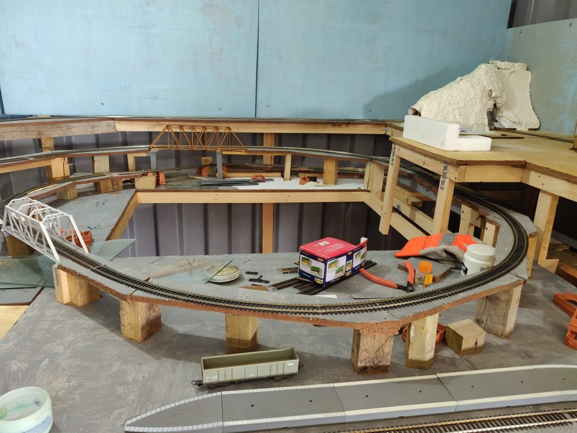

An update on what the baseboard looks like now.
