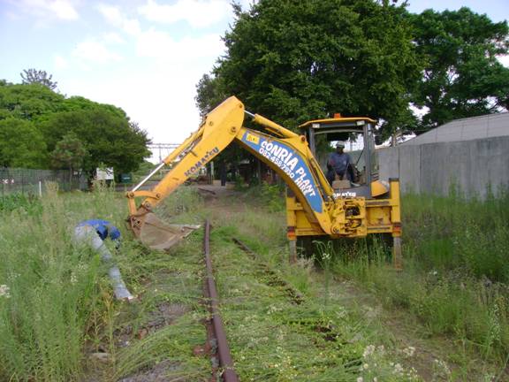

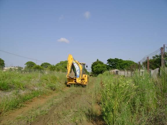

The cutting to the TFR yard was cleared and scraped where necessary.

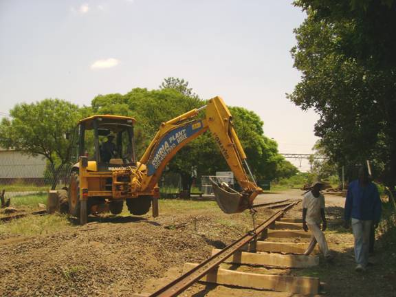

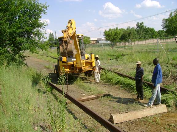

The rails heaped at the top of the cutting were moved clear of the cutting.

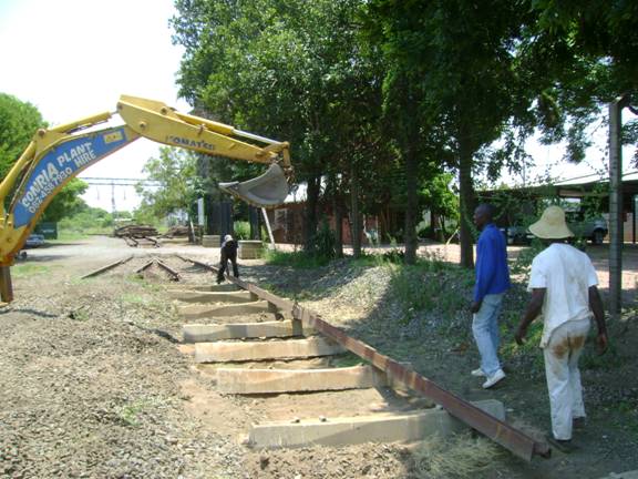

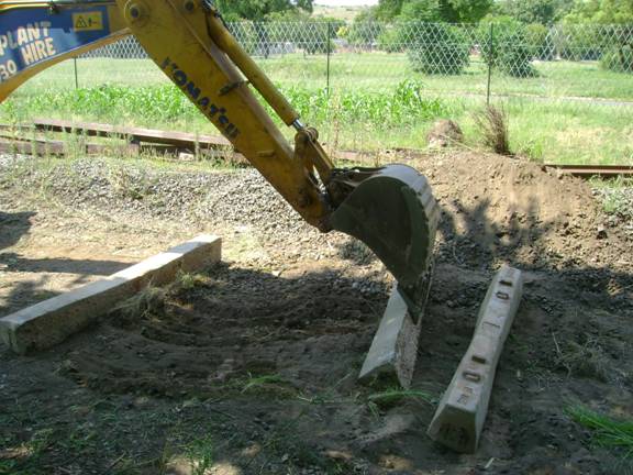

Eighteen concrete sleepers were moved into the cutting and have been laid 1.5 metres from each other. The sleepers still need to be aligned against where the proposed line will run.

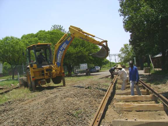

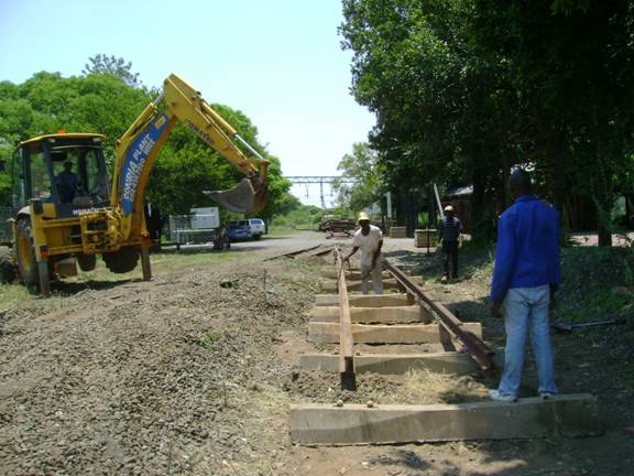

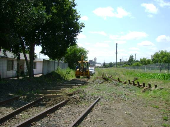

An initial section of two rails has been laid on top of the first seven sleepers.

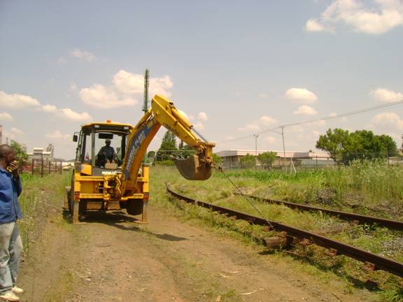

The two long continuous sections of rail have been moved into either side of the cutting.
