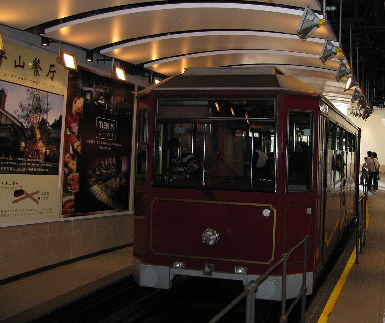

Waiting to collect passengers.

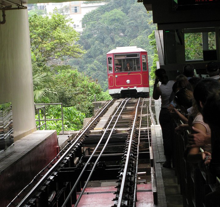

A tram arrives roughly every 8 minutes and there are 2 using the track at any given time with a loop in place just shortly after the ground level terminal.

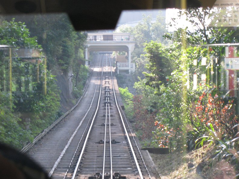

Drivers view of the tram heading uphill

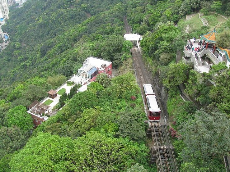

The tram almost at the peak.

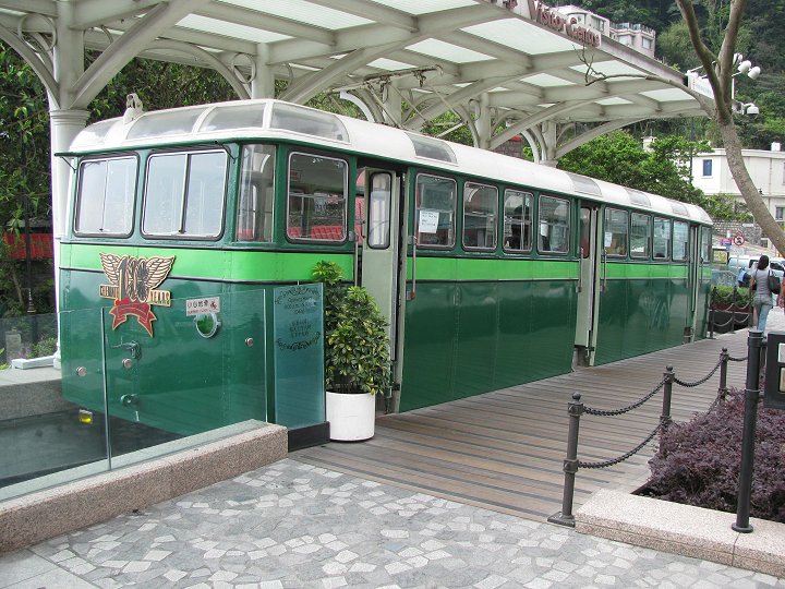

a 1948 vintage tram car on display

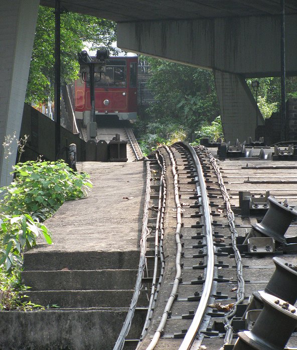

Thanks Derek. Fantastic photos. From the photos the haulage rope, or cable, is only viable on the uphill side of the tram. Is that right? Tom
Re: Hong Kong Peak Tram
Tom, I expect its only viable to have the haulage machinery at the top, but I am no expert in these things and maybe there is a way to have the machinery at the bottom and run a pulley system that goes up and then down, but that could leave half of the cable permanently exposed which could lead to trouble I expect. Unfortunately there was no way to ask anybody about the internal workings of it all.

"viable" was a typo. I meant "visible". In the photos the double line of cable lying in the rollers is only present on the uphill side of the tram. Thanks, Tom
