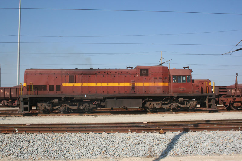

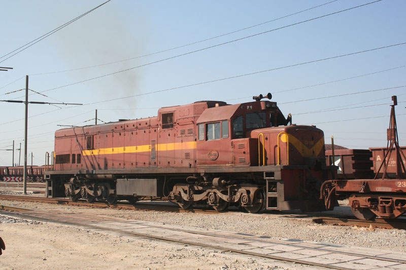

The yard uses two Class 33 Diesels to shunt the ore carriages too and from the Ore harbour and Saldanha Steel. Each section is 115 wagons long plus two flat beds. Its amazing to see these old Loco's still in use and powering such a heavy load. Each 33 has two flat bed coaches in front of the ore wagons. A Shunter explained that is was to absorb the shock as they have to shunt these wagons hard. This does not make sense to me. If anyone can help me on this topic I would appreciate it.

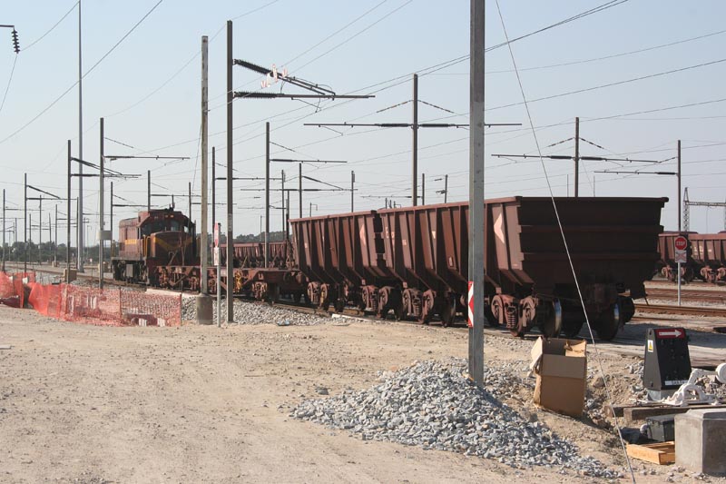

- Part of the B section

Nice shots Stefan, I can imagine how nice those 33's sound shunting those heavy loads.

Thanx Fanie. The growl of those 33's are amazing

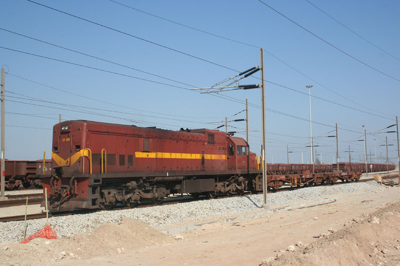

The use of flatcars mystifies me - hard shunting should not be absorbed by a flatcar - surely all forces would be transferred to the locomotives drawbar, leading to yet another bent frame on a class 33....

I also couldn't find anybody who knew what the flatcars were for. The only thing I could think was something to do with the tipplers for off loading the ore. Perhaps the diesel is too heavy to couple directly onto the wagons in the tippler.

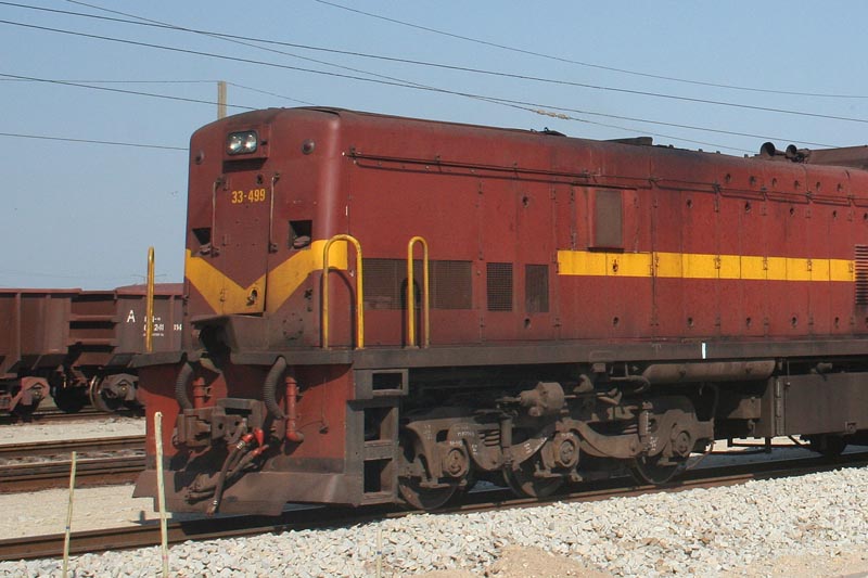

Maybe a silly question, but do the Class 33s have air brakes? If not, then there's your answer.

I think you have hit the nail on the head, as I recall the 33 class diesels do not have air brakes.

Though looking at Stefan's third picture there are certainly additional hoses beneath the coupler, other than the vac pipes higher up. Well, maybe there was a fault.

Years ago, more than I care to remember, I often used to ride the diesel shunt locos around my Rhodesian home town. When shunting fuel tankers into the fuel company depots, it was necessary to have at least two or three goods wagons between the loco and the tankers. This was so that the loco did not need to enter the fuel depot gates when pushing the loaded tankers in or pulling the empties out. There was a sign prohibiting locos from passing through the gates. This probably originally applied to the old steam shunt locos, but was apparently still in force for the diesels (or was it the loco crew's cigarettes - smoking was de-rigour in those days).
On the basis of that knowledge, I prefer Aiden's theory. Namely that the diesels themselves cannot go into the tippler shed to couple the ore-wagons, especially if they are just beyond the tipper itself. Both the shock-absorbing and extra braking power theories sound too tenuous to me.
It would seem from the pics that the diesels are indeed air-brake equipped: the air hoses are there -- to have 115 fully loaded ore-wagons braked only by the two locos and two empty flat-cars would be suicidal, particularly if a coupling should part. Even if the ore-wagons were dual-braked (which I do not think they are, I see no vacuum hose on the one in the picture), 115 wagons far exceeds the maximum number permitted for vacuum braking. Not only that, but two unloaded flat-cars would add almost no braking power that is worthwhile before their wheels skidded.

I know zip about this stuff, but 1 thing springs to mind. Visibility. The diesel driver can see the cars over the length of the flats, they are not up against his bonnet. But then I saw something that puzzled me, what is the tripod like object on the one flat car? Could that not have something to do with it?

Derek thats what I thought. Those tripod things seem to be for the shunters. There is a stair below the tripod and they climb up there. Surely they would not build such a large structure for them to hold on. Steve all those wagons are air braked. So I assume that the 33's and 34's have all been modified for airbraking. In the this close up you can see the 33 fitted with airbrakes

1. I also saw that tripod thing mounted on the deck in the flat-car pics and am wondering what it is for. I also like the idea that the flat-cars could be there to improve the sighting from the diesel cab.
2. I see from the close-up pic that there is not one but two air-brake pipes. Might I be correct in assuming that the Orex trains therefore use a "two pipe" air-brake system similar or identical to the one described at Railroad.net? http://www.railroad.net/articles/railfa ... /index.php . All other TFR air-brake trains that I have seen use only single pipe if I recall correctly. Is someone able to add info on this?
