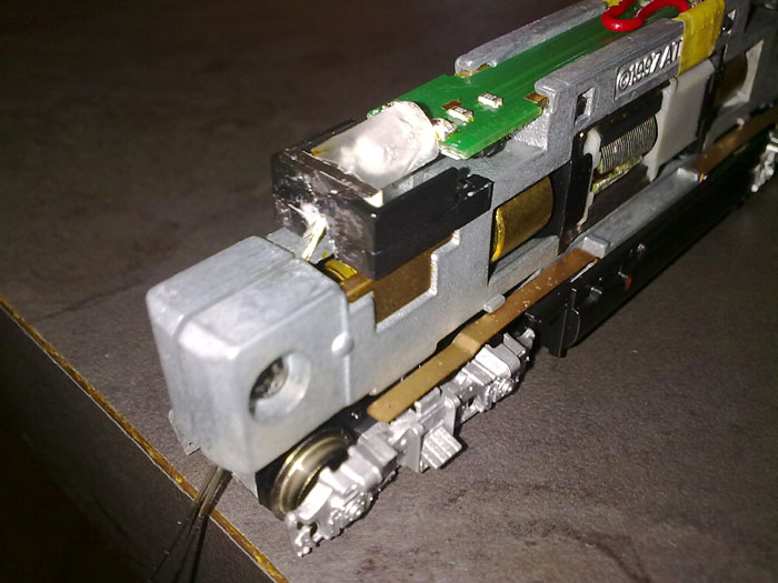

These N scale diesels dont have ditch lights so after searching around on the web I found that you can easily make some using fibre optics. So here is how I did it... After taking the shell off make 2 small holes in the front where you want the lights using a hot needle, it goes through quite easily. Now the tricky part...When you bend the fibre to much they break and the one end have to be right at the LED otherwise the light on the other end is very weak. So after trying various ways to do it in the end it was quite easy. I glued a small piece of straw over the LED, push the 2 fibres then through the gap between the 2 frames into the straw. And cut a small gap in the bottom of that black plastic in front of the LED. The other 2 ends at the bottom is then pushed through the 2 holes in the nose, carefully fit the shell over the frame again, cut off the extra fibre sticking out in front and using a soldering iron melt the tip of the fibres till it looks like a little mushroom. I did this melting with the other end as well. The only problem doing it this way is that if there is a problem with the loco and you have to take it apart you will have to cut the fibres but that is easy to replace again.
- Here you can see the 2 fibre pieces through the frame into the straw.
- 08082011152_ditch1_.jpg (93.27 KiB) Viewed 48209 times

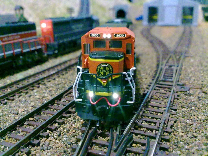

- The end result.
- 07082011150_ditch2_.jpg (130.3 KiB) Viewed 48209 times
Re: 9.N Scale garage layout
That's really clever, Fanie, and the photo of the loco with the lights on is very impressive.

Nice work and in N Scale as well! I've used fibre optics for the red lights on a HO scale Class 34 (the lights on the back of the hood and front of the cab) and it's a neat trick.
Where did you get your fibre optics from? I normally raid the Christmas tree (much to the disgust of certain people in the family), that has fibre optics that gives pretty colours

Niel I got the fibres from a plastic toy thingy, a friend got it for me from a chinese shop..
