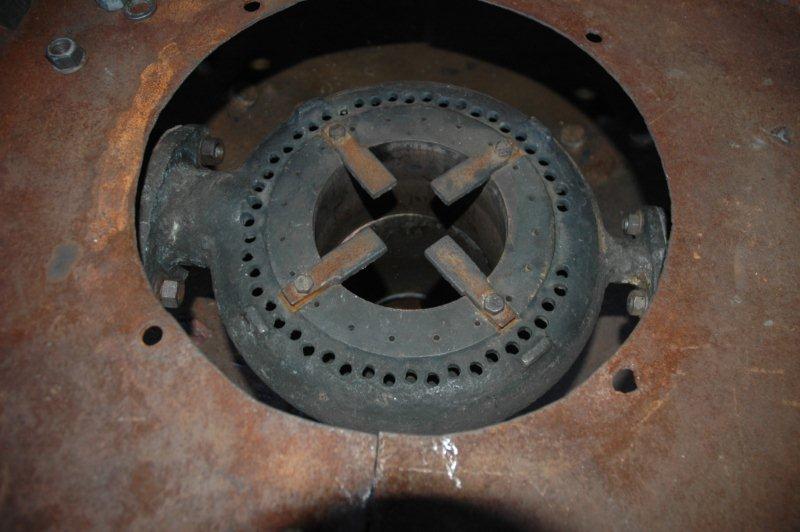

A nice way to see the workings of the smokebox. Here is the blast pipe cap and the four Goodfellow Tips which break up the blast and create some back pressure.

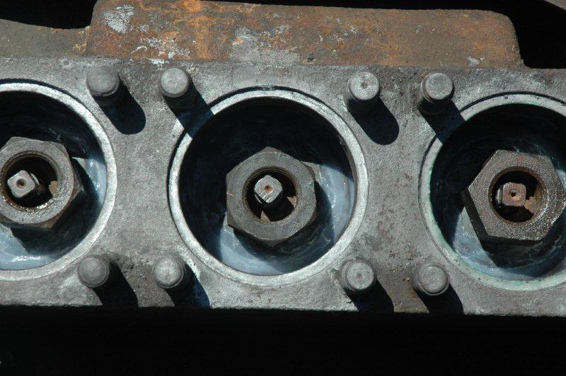

Sealed up with a silicon, the valves in the regulator header can be seen. The reason for the silicon is that the boiler is undergoing its hydraulic pressure testing.

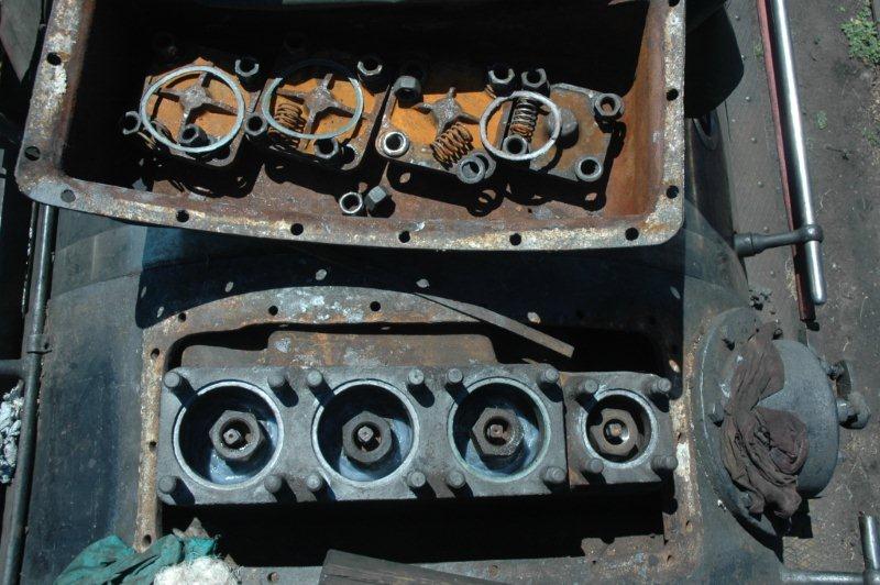

The complete regulator set of valves including the smaller Pilot valve on the right with covers, ready for closure. The pilot valve opens first when the regulator is opened and then steam will be admitted in a sequence to the other valves.

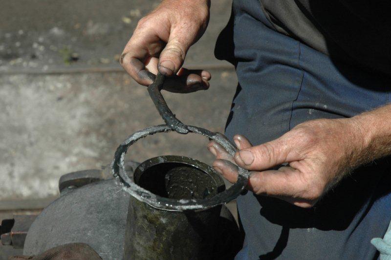

The fibre gasket must first be smeared with an oily graphite mixture prior to the regulator valves covers being replaced.

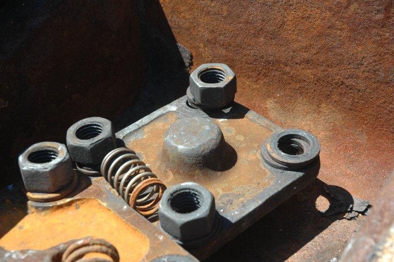

The regulator valve cover plus it's spring.

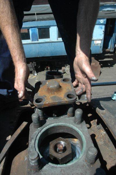

Carefully placing the cover in position

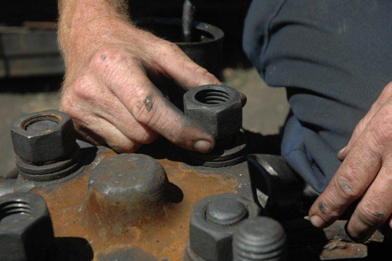

Correct nuts in the correct place and the cover will seat and tighten up better.

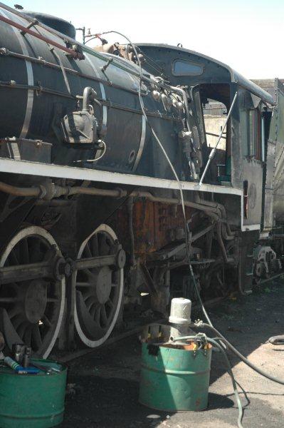

The set up for the boiler hydraulic testing. There is an air operated pump situated in the water-filled drum. A pipe leads from the pump up to a controlled valve on top of the boiler where a washout plug is situated. The water will be pumped into the already-filled boiler, to bring the pressure up to the required mark on the pressure guage.
capital Park class 19D progress. March 4th2012 023.jpg (42.53 KiB) Viewed 8714 times
Spikkels looks at the pressure on the gauge. The hydraulic testing is always way over the normal working pressure of the locomotive, for safety testing reasons. The pressure must hold for at least 30 minutes, to satisfy the boiler inspector, before she will be passed for service.
