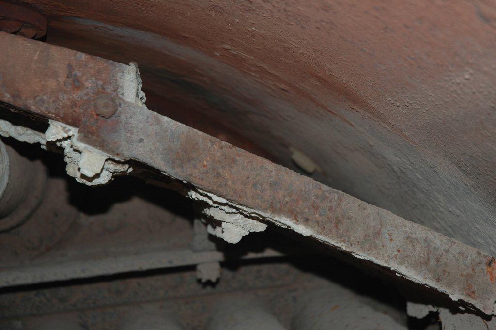

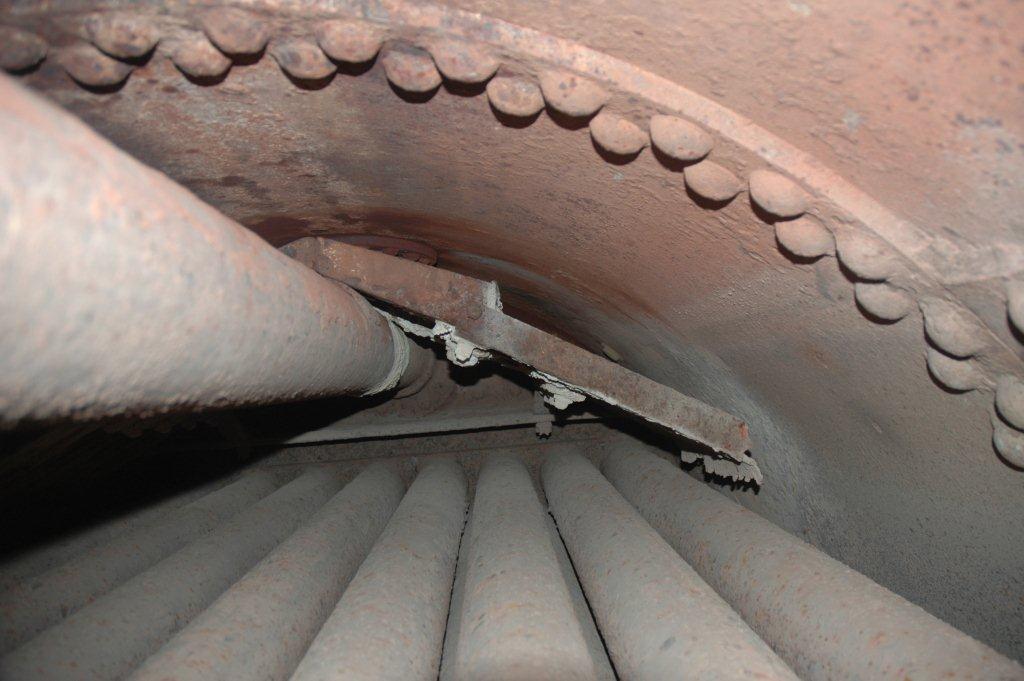

The tubes convey the heat generated in the firebox to the smokebox, while at the same time heating the water around them, much as an electric element in a kettle, thus generating steam which the locomotive uses to get in motion. The main pipe on the left upper is the main steam pipe, into which the steam collected in the dome, will travel to the superheater and onwards to the steam chest. Directly in front can be seen what are known as Baffle Plates. These plates are perforated and are situated directly under the clack box which enables the water to be fed into the boiler via the injectors. The cooler water entering is thus broken up and will heat faster and not create a huge loss of temperature.
FOTR UPDATE AUG 2012 012.jpg (86.49 KiB) Viewed 9456 times
Closer look at the Baffle Plate
FOTR UPDATE AUG 2012 013.jpg (81.91 KiB) Viewed 9456 times

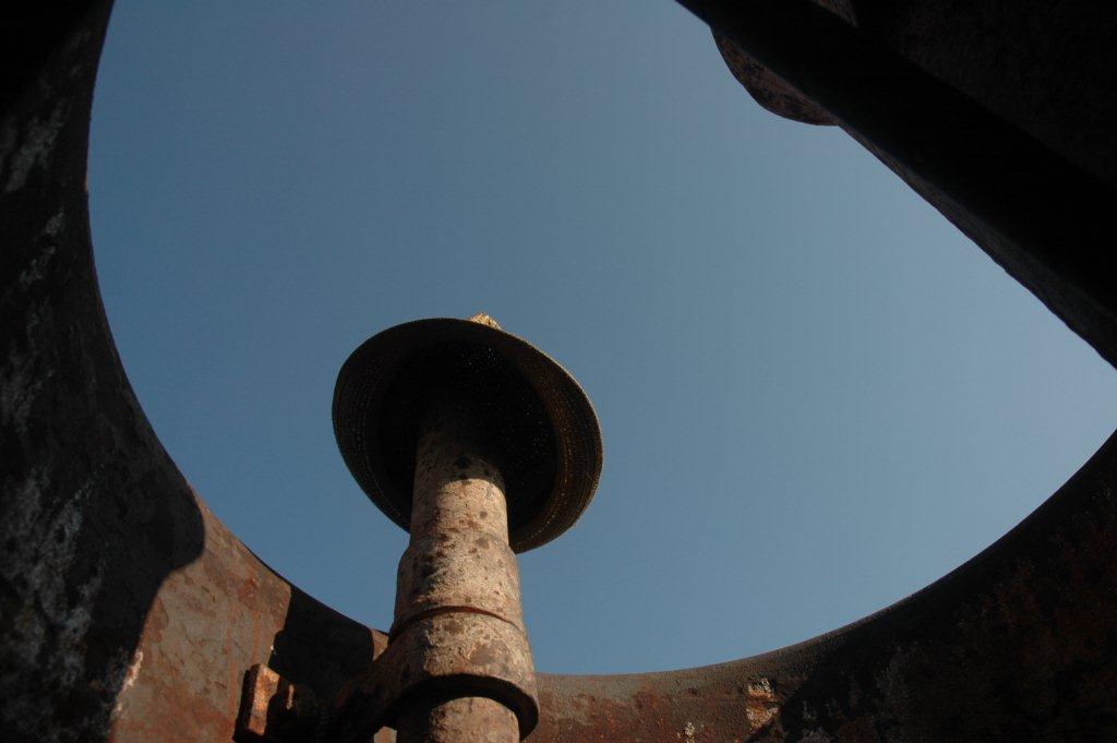

Lying on my back looking up and into the dome of the locomotive area. My hat perches upon the main steam collector pipe, which will convey the steam onwards to the superheater header. Directly above but not clearly visible is a second collector pipe for steam to the turret by the cab, which provides the raw steam for operating the various auxiliary gear such as steam shaker, reverser, etc, via the control spindles in the cab.
FOTR UPDATE AUG 2012 015.jpg (49.76 KiB) Viewed 9456 times
