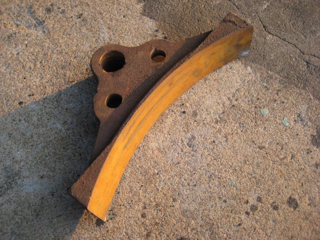

An old cast iron brake block - very worn!<br /><br />Photo by John Ashworth 24/02/08

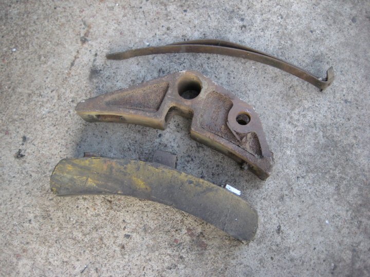

From the bottom - a composite brake block, its holder, and the spring that holds it in<br /><br />Photo by John Ashworth 24/02/08

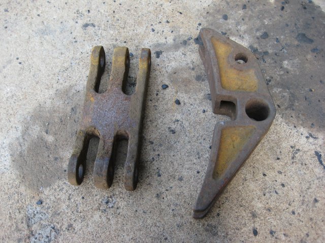

A composite brake block holder posed next to one type of hanger<br /><br />Photo by John Ashworth 23/02/08
