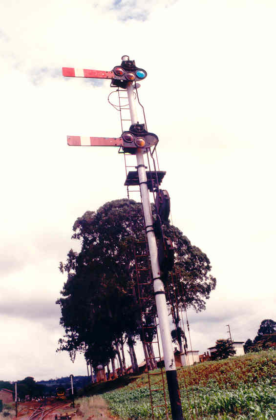

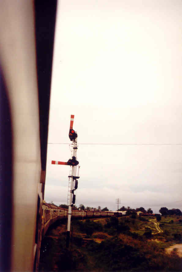

A three aspect semaphore? Danger - level, caution - 45deg, all clear - vertical. That right?
Re: Kenya - semaphores
I'm not sure, actually, Steve. I don't know whether it's three aspect, or whether it simply doesn't have a 45 degree position - only horizontal and vertical. Hopefully somebody out there on the forum can tell us?

In the centre of the three pics, the upper semaphore arm distinctly has 3 lenses, red, yellow and green. It would appear that it can display all three aspects.
The lower arm on the same post has only two lenses, red and yellow - presumably danger at horizontal and caution at 45. I guess this signal acts like a distant, showing danger and caution only.
The top pic shows the top arm at all clear - vertical.

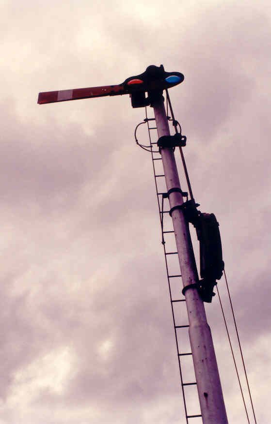

The lower pic shows a semaphore arm with what also looks like only two lenses, red and green in the horizontal and vertical positions only. The intermediate centre position appears to be blanked. Presumably this signal can only display the two extreme aspects, danger and all clear, like a home signal.

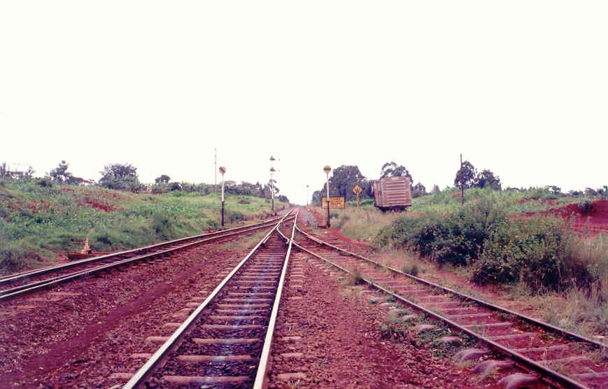

Looking at the centre pic again, it would appear that the top arm is for the through road, whilst the bottom arm is for the loop. Standard practice in the UK and SA too. This would explain why the bottom arm has no 'all clear' position: there is a turn out to be negotiated into the loop.
I also notice that what seems like the 'starter' signals are not semaphore arms, but disk signals (similar to those found here but black and yellow), one of which is set to clear and the other to danger.
Well spotted, Steve. I hadn't noticed the lenses. And you're right that the lower arm is for the loop.
Those discs might be route (points) indicators, not starting signals. If the train control in Kenya is anything like in South Africa, then you wouldn't normally find starter signals on single track. Dagoretti Station has a station master and token equipment, so presumably the driver would be given authority to proceed by the station master giving him the token.
Yes, John, you would be right then, the discs would essentially be points indicators. My guess is that by using 3-aspect semaphores, they saved on the need for a separate distant signal, probably relying on a 'warning board' of sorts further out as is also done in some places here.
