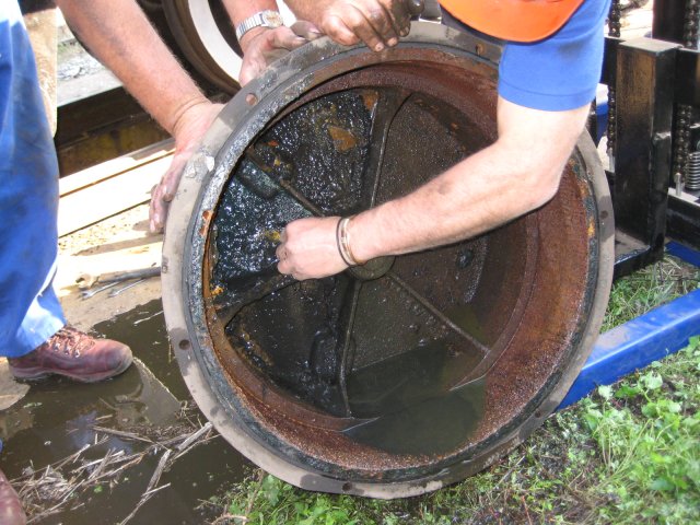

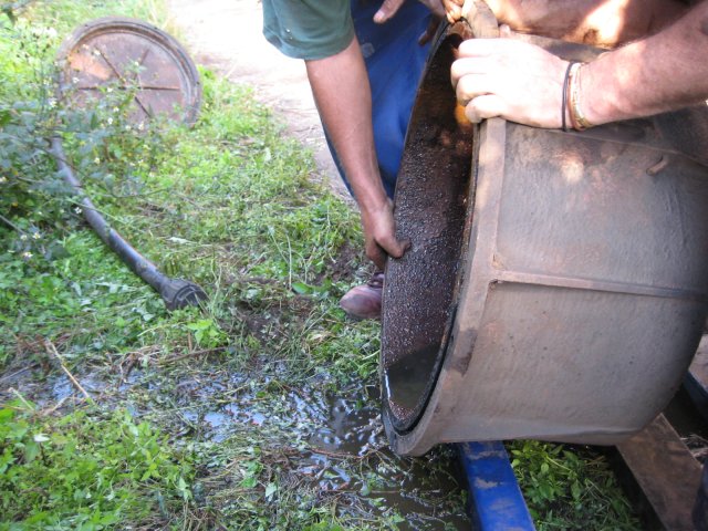

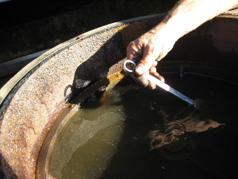

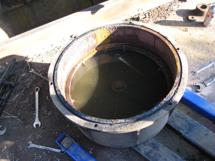

When we put vacuum through 3117 for the first time we picked up a problem. Subsequent investigations showed that the vacuum pans on the tender were full of water - and not just water, but rust and sludge. The pictures show the pan on the driver's side after removal.
Photos by John Ashworth 10th May 2008
3117 - vacuum or water?
- Vacuum pan, water and submerged spanner
- IMG_0434s.JPG (94.94 KiB) Viewed 1268 times
- Pouring out the water
- IMG_0436s.JPG (100.65 KiB) Viewed 1265 times
- Scraping the sludge
- IMG_0437s.JPG (98.23 KiB) Viewed 1265 times

It is most unusual to get water in these chambers, but we have a theory how it happened. This rust and junk means now that we have to refurbish them and we look at more delays on getting 3117 to steam.
