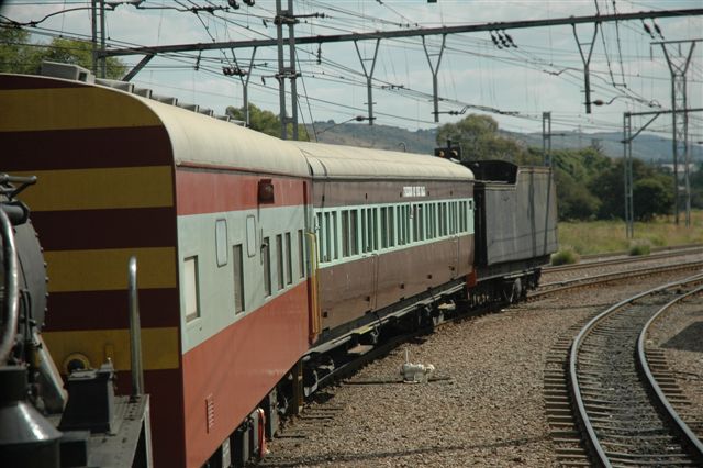

Nathan wrote:An unusual tender first working. The ex class 23 tender plus two vehicles
are propelled by 19D 2650, en route to their new site at Hermanstad. A
problem with the circuits at CTC made possible this direction of travel, at
a sedate 10KPH
Photo by Nathan Berelowitz 12 April 2009
CapparkHercules 12 April2009 009.jpg (68.22 KiB) Viewed 8736 times

In this particular case I suspect the 10 kph was because of the state of the spare tender, which hadn't run for a long time.
