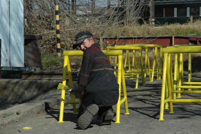

Ready to perform the railway olympic trestle sprints, is "Spikkels", armed with paint brush to touch up any spots missed as he takes flight over them!

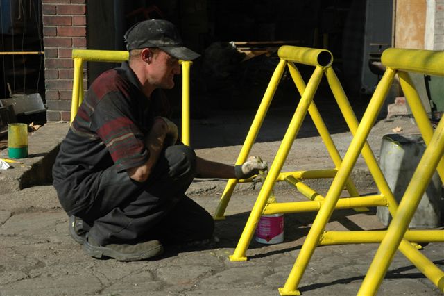

"A little beet to theee left and some moore on der side.." Spikkels at work ensuring every speck is painted.

Are these for crowd control
Gabor Kovacs
Friends of The Rail
Posts: 654
Joined: 10 Jun 2007, 20:39
Re: FOTR hurdles
Post by Gabor Kovacs »
Not quite Stefan!
They are to be used, when the Class 24 - 3664, has her connecting rods and motion removed, as the locomotive is due to be re-bushed soon.
The trestles will be used to place the rods and motion on, to keep them for lying on the sandy ground and preventing dirt build-up while the new bushes are manufacutred!

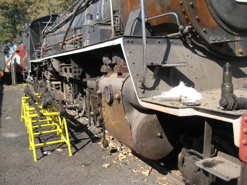

Some idiot has put connecting rods on top of the hurdles, which will make it very difficult for the athletes to jump over them...
Photo by John Ashworth 25th July 2009
Re: FOTR hurdles
Don't you need a block and tackle to lift those. They look very heavy

Is FOTR also going to put Vesconite bearings on their locos now?
Luca Lategan...
Re: FOTR hurdles
No, Luca. We have already had new bushes cast. They now need to be indivdually machined to size. Vesconite cannot handle the high forces that the con-rod journals have to endure. RS has sucessfully used Vesconite for the bushes on the lighter loaded valve gear, I believe.
