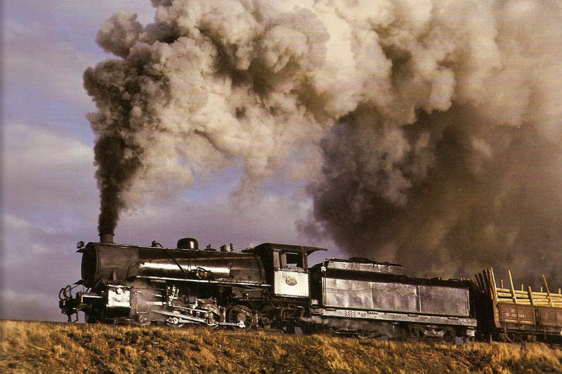

Paxton and Bourne tells us that the S class, numbered 360-373, were 0-8-0 tender locos built by Henschel in 1928-9 for shunting work. Experts on this forum will no doubt be able to tell you more details of this particular loco, 365.
Re: SAR Engine 365 S ?
S denotes Shunter. These 0-8-0 Loco's were the first Loco's purely for shunting S 369 is seen working near Roodepoort. This photo comes from the Great Steam Trek. We had the S2's here in Cape Town.As a family we would go to the docks on a Sunday to watch the ships.(Circa 1967) I would watch the S2's going back and forth. Outside F or G birth was their resting place , where at any one time 20 of these S2's could be seen hissing away.
S369
S369

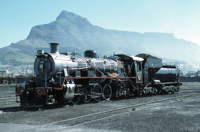

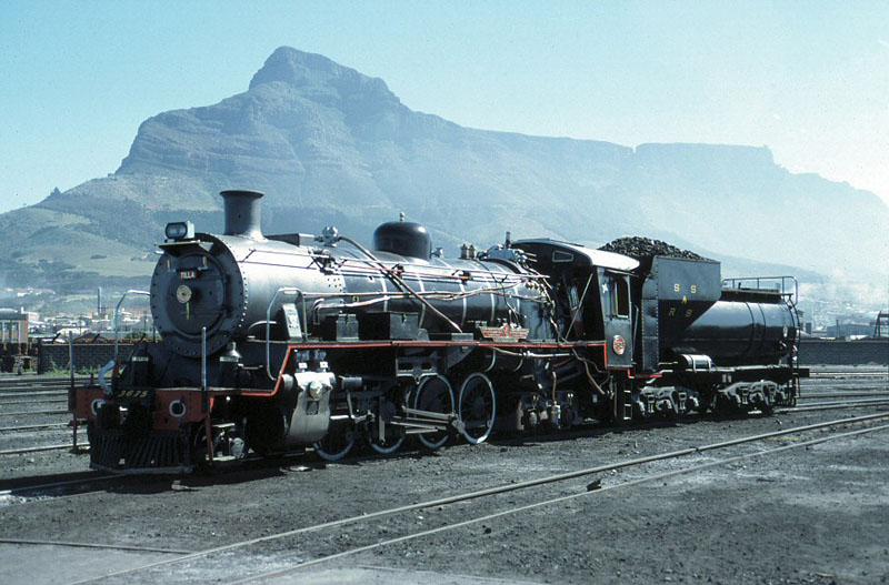

A typical Cape Town harbour scene. S2 doing her thing.Although just a shunter she is immaculate . I think this is a Sue Lawrence photo.With no leading wheels they were restricted to 50 or 60 km/h. They could go faster in reverse.
S2
S2
Blimey, for a shunter that is a seriously clean engine.
This is definately not the original plate which would have single language only. Again, the bolt holes are not correct and you can see this pattern is made to accomodate a variety of numbers. Most likely it was cast as a replacement and the loco was withdrawn before it was fitted or it was made as a presentation to a staff member of importance. I have a 15CA plate with the same small holes which was presented as a gift to an engineer.
Still a good souveneer. Drill the holes out correctly, and in 20years time, it will be original!
Martin you are correct. Looking closer you clearly see the 2-8-4. When I downloaded this photo it was labeled as a S2. Sorry for the incorrect info. Its a great photo though with Table Mountain in the back ground.
