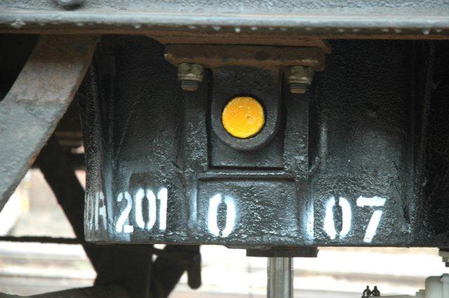

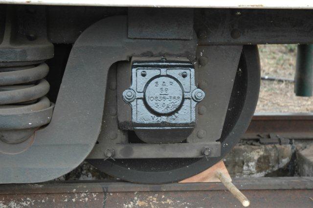

Axle boxes, bearings and wool packings checked and ok. Cover is painted black
coach lifting 001.jpg (40.3 KiB) Viewed 6127 times

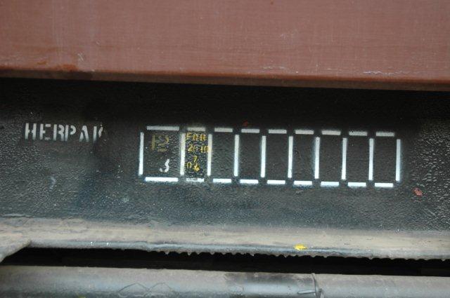

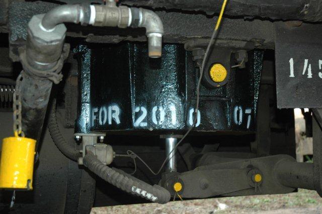

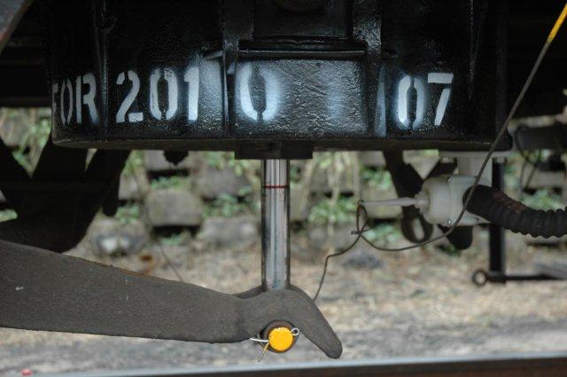

Vacuum cylinder stencilled and FOR depot code used. Note the ring marked on the piston rod of the vacuum cylinder. This will be the mark to show drop off once vacuum created. Must hold at least 10 mins before leaking off. This one well over an hour
coach lifting 003.jpg (40.09 KiB) Viewed 6127 times

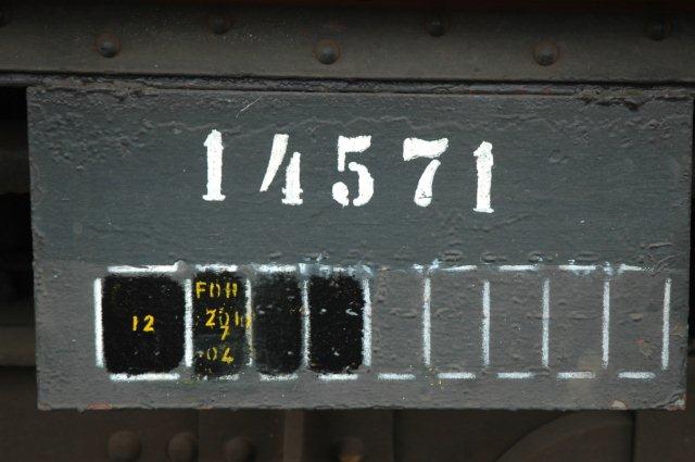

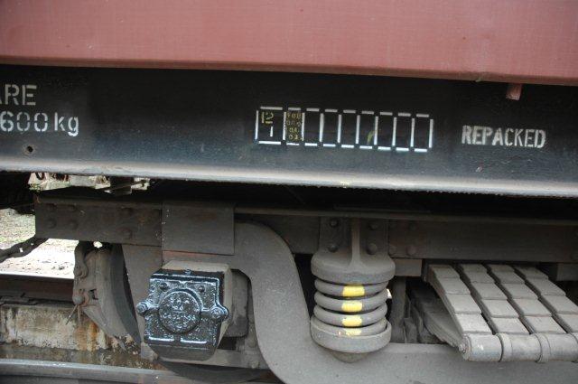

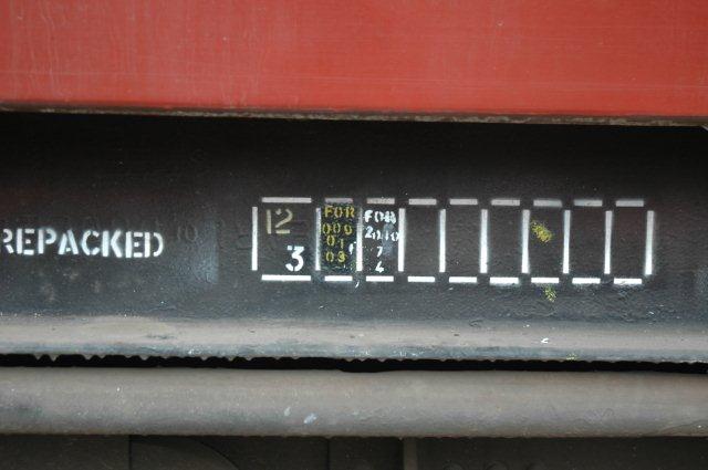

Yellow for lifting dates. There was no stencil to place 60 for the months between lifting, so it reads 12, this will be sorted out soon. The white script is the oiling dates on a three month cycle.
coach lifting 004.jpg (38.02 KiB) Viewed 6127 times

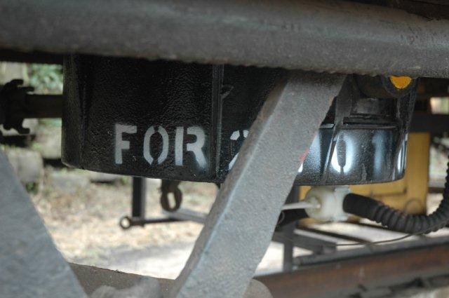

Vacuum pan stencilled with date
coach lifting 016.jpg (45.84 KiB) Viewed 6127 times

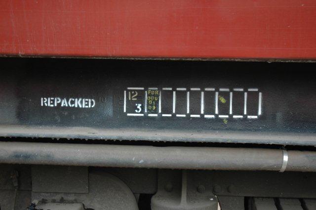

Oiling dates placed..
coach lifting 027.jpg (33.82 KiB) Viewed 6127 times
