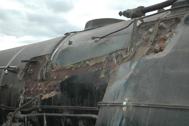

- Cut away lagging revealing the boiler rivets and stays. Ultrasonic metal particle testing was done over the weekend of 3/4July, and the results are very positive that apart from a few flexible stays that need replacing, the boiler looks very good.
- coach lifting 018.jpg (46.89 KiB) Viewed 6877 times

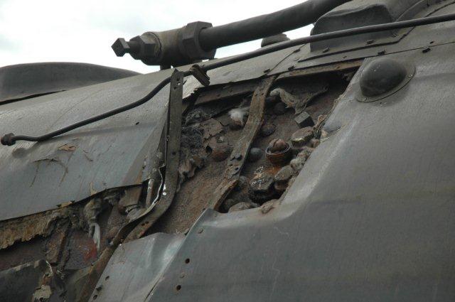

- Firebox stay damage
- coach lifting 019.jpg (38.26 KiB) Viewed 6877 times

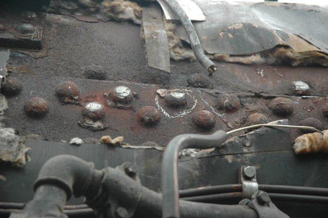

- View of damaged side with lagging removed to show the damage to rivets and stays
- coach lifting 020.jpg (38.7 KiB) Viewed 6877 times

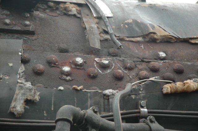

- The circled rivet is suspect but the others look ok.
- coach lifting 021.jpg (48.47 KiB) Viewed 6877 times
