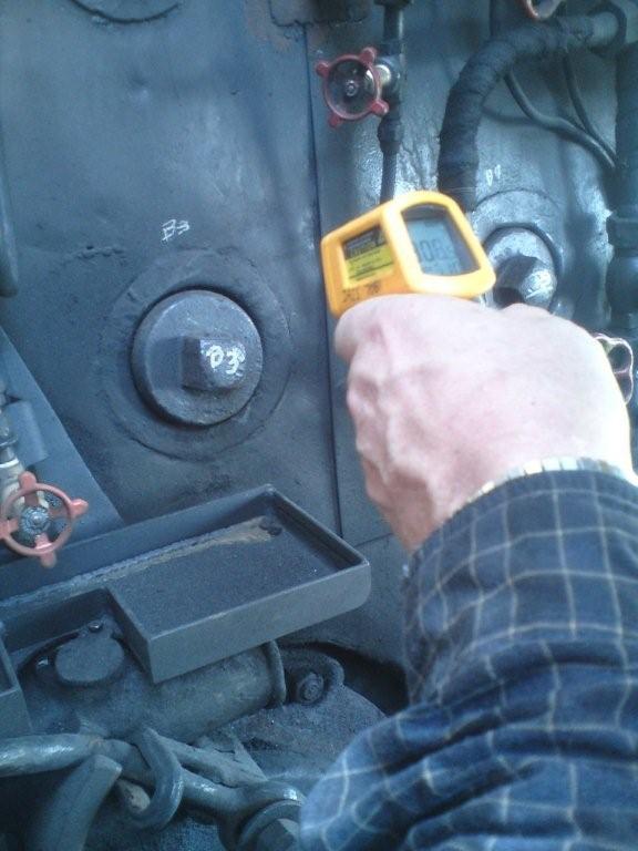

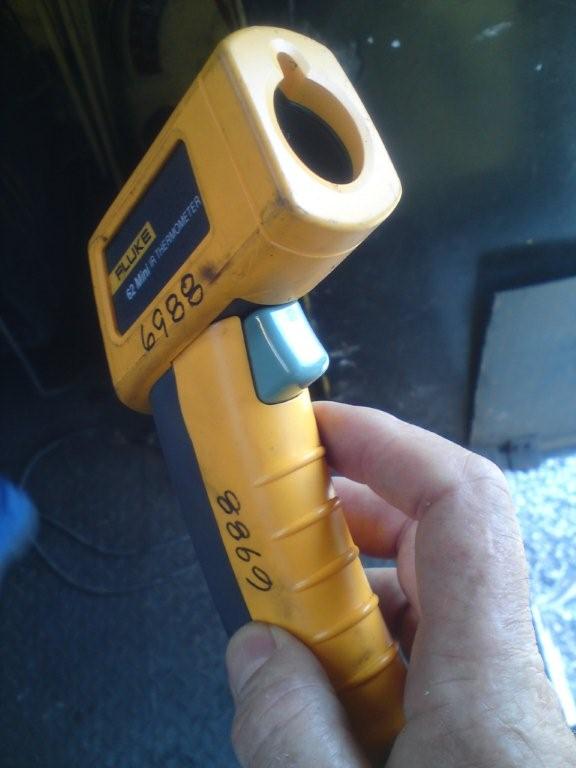

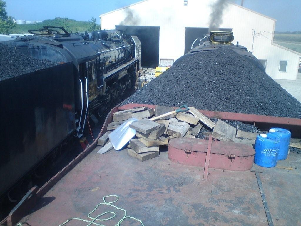

Light up - See pics 011 & 012 Industrial hot air blowers are placed at the firebox door for 12+ hours before light up. The boiler is thus slightly warmed when fire lit. Steam raising was monitored by taking temperature readings with the laser off washout plugs.[Note all washout plugs nicely numbered]

003.jpg Hand held laser temperature gauge
007.jpg taking temperature reading off washout plug
011.jpg Hot air blowers
012.jpg Hot air blowers
