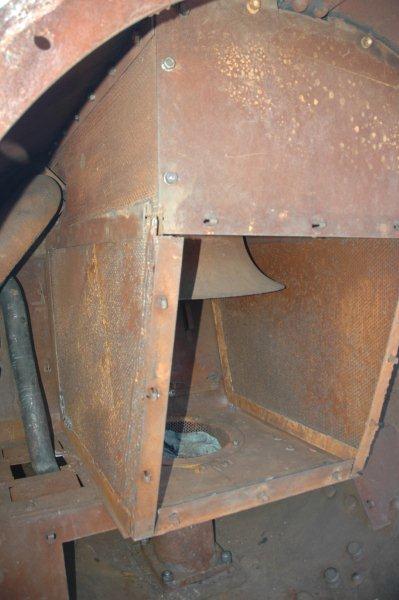

Spark arrestor arrangement in the class 19D. This is a box type as opposed to the familiar screen type of spark arrestor.
Capital Park progress on 19D 2650.March 2012 012.jpg (38.51 KiB) Viewed 7518 times

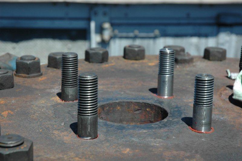

Renewed studs on the dome for the safety valves. The rear studs were badly worn and thus new ones were machined. This was a time consuming task performed by John Dadford.
Capital Park progress on 19D 2650.March 2012 013.jpg (56.69 KiB) Viewed 7518 times

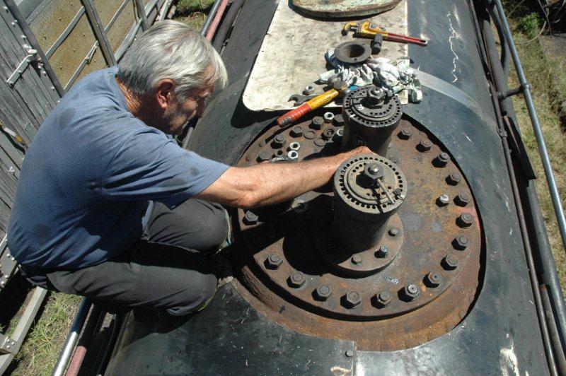

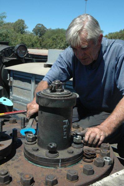

John Dadford tightens up the bolts on the first safety valve in place after the hydraulic test.
Capital Park progress on 19D 2650.March 2012 015.jpg (44.76 KiB) Viewed 7518 times

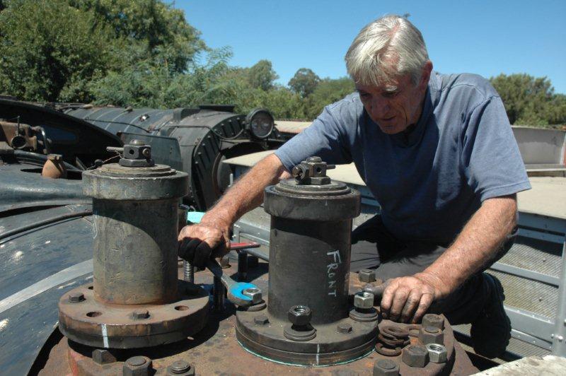

John tightens up, while the rear safety valve awaits fitting. A hot task in the open under sunny skies. Blessed art thou who have a shed!
Capital Park progress on 19D 2650.March 2012 016.jpg (78.08 KiB) Viewed 7518 times
Both safety valves now in place and the final tightening up
Capital Park progress on 19D 2650.March 2012 019.jpg (93.65 KiB) Viewed 7518 times

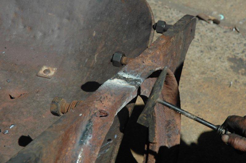

The firebox door frame needed to have a crack welded up. John tackles this task and soon it is fitted into the loco.
Capital Park progress on 19D 2650.March 2012 022.jpg (58.46 KiB) Viewed 7518 times

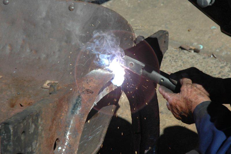

John welds the firebox fire door frame.
Capital Park progress on 19D 2650.March 2012 023.jpg (56.5 KiB) Viewed 7518 times

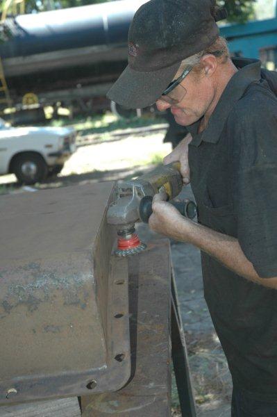

Spikkels prepares the regulator valve cover for painting.
Capital Park progress on 19D 2650.March 2012 025.jpg (32.13 KiB) Viewed 7518 times

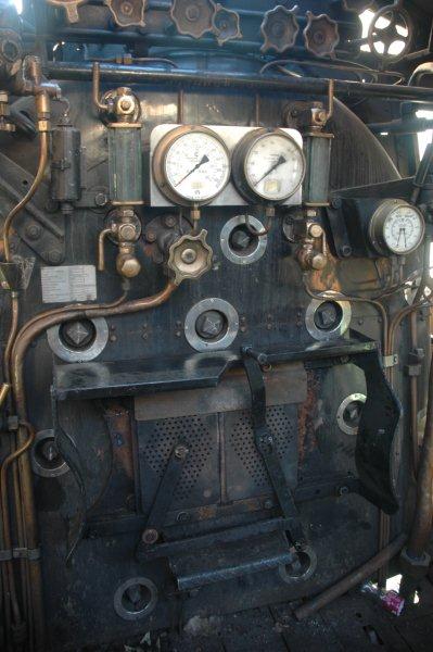

At last the cab interior is complete. Robert Dadford fitted the guage column cocks after removing the blanks from the hydraulic test. John Dadford, Spikkels and Nathan fitted the firehole doors.
Capital Park progress on 19D 2650.March 2012 026.jpg (45.46 KiB) Viewed 7518 times
