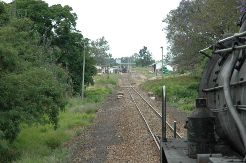

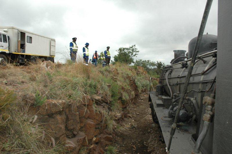

From the cab of the 24 class approaching the derailment point in the cutting

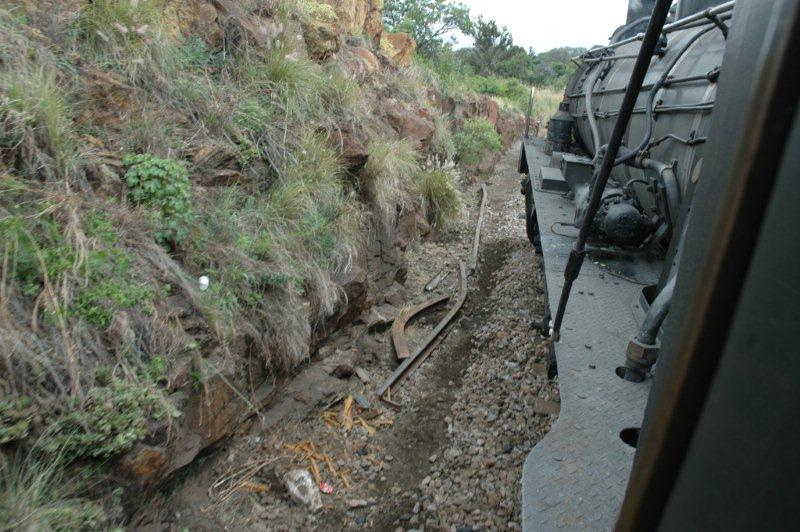

Damaged rails removed.
december Cullinan train 2012 015.jpg (91.14 KiB) Viewed 1243 times

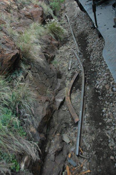

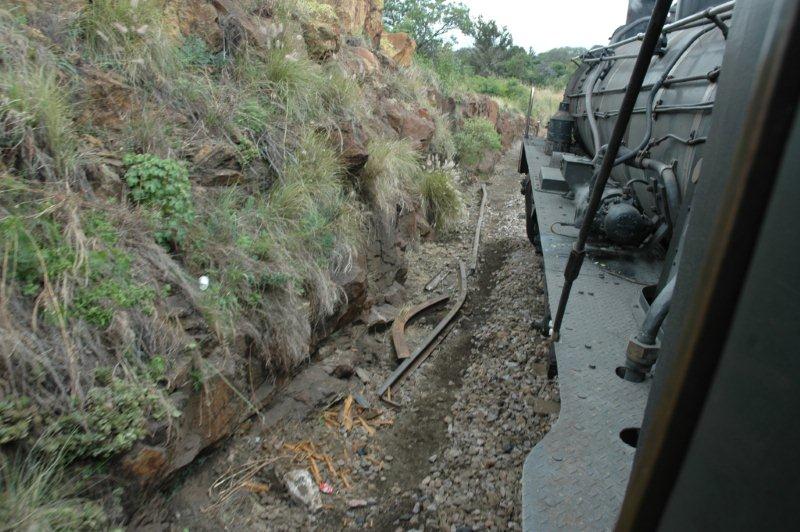

Damaged rails
Damaged rails
december Cullinan train 2012 016.jpg (64.78 KiB) Viewed 1243 times

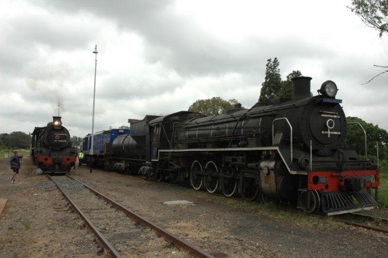

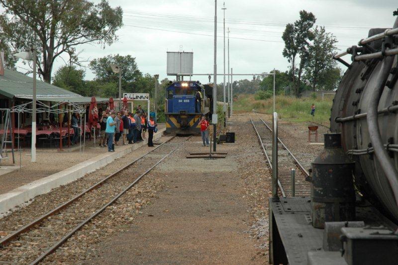

Arriving Cullinan with 34 class and 19D at platform
december Cullinan train 2012 018.jpg (82.34 KiB) Viewed 1243 times

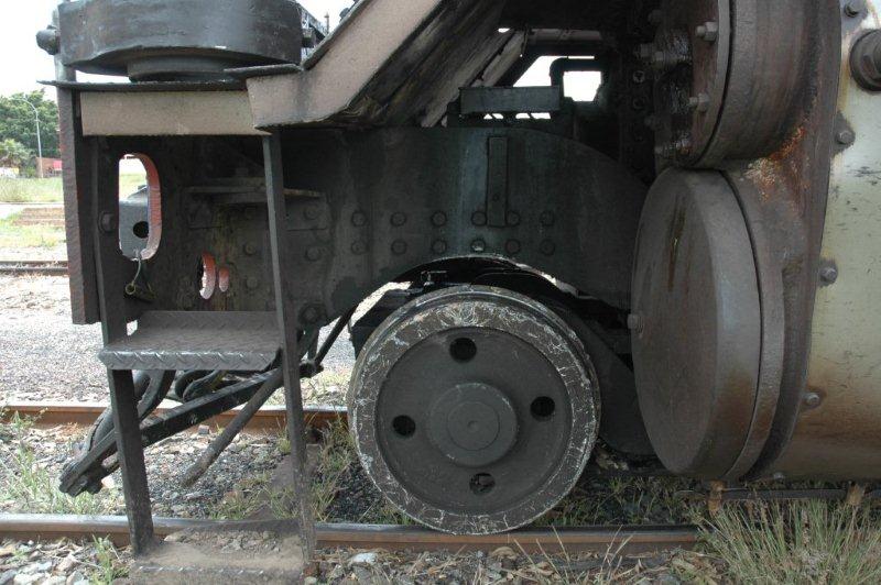

The class 24 has arrived at Cullinan and the passengers are off, while the 19D, with rods removed and work ongoing on the other side to replace tender bearings, waits with its hauler, the 34 class diesel, to take her back to Capital Park after the derailment due to sleeper theft on the same spot as the 2010 derailment.
december Cullinan train 2012 024.jpg (62.93 KiB) Viewed 1251 times

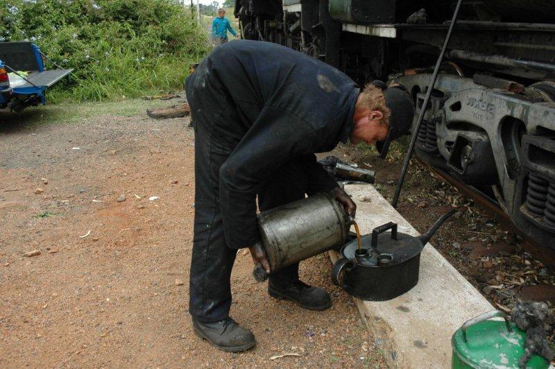

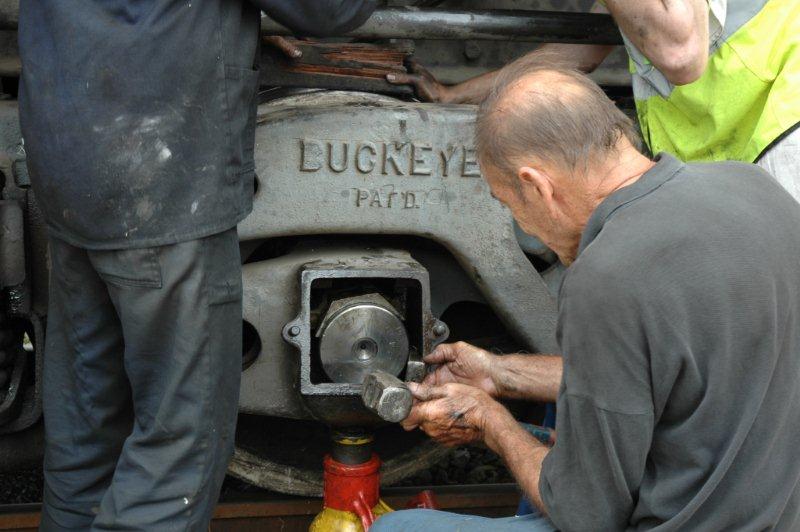

Spikkels, Phillip and Robert Dadford replace the damaged bearings
december Cullinan train 2012 028.jpg (45.81 KiB) Viewed 1251 times

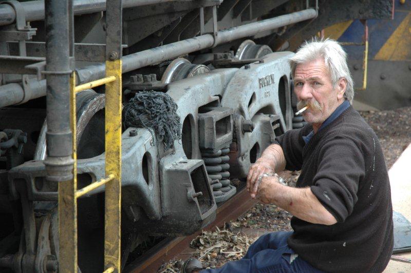

Willem Ras busy with the bearings and removal of the wool packings.

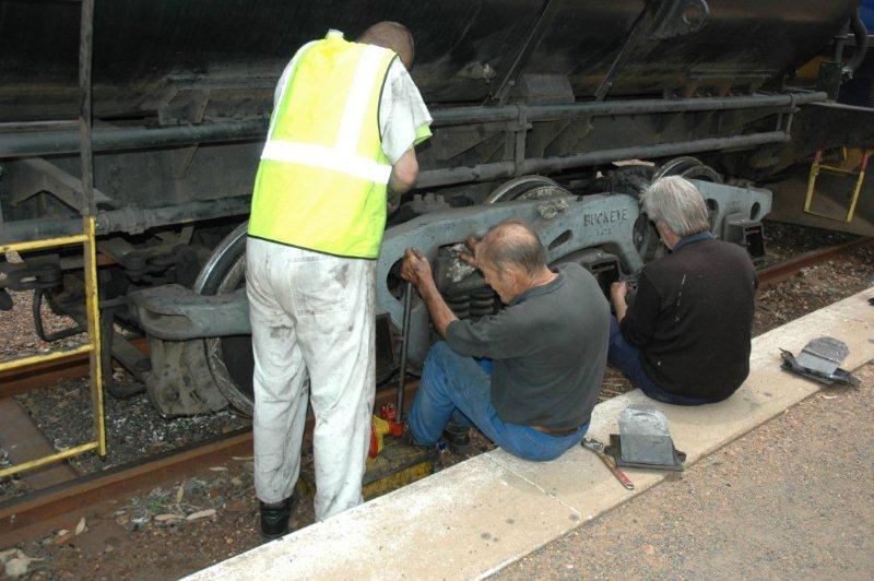

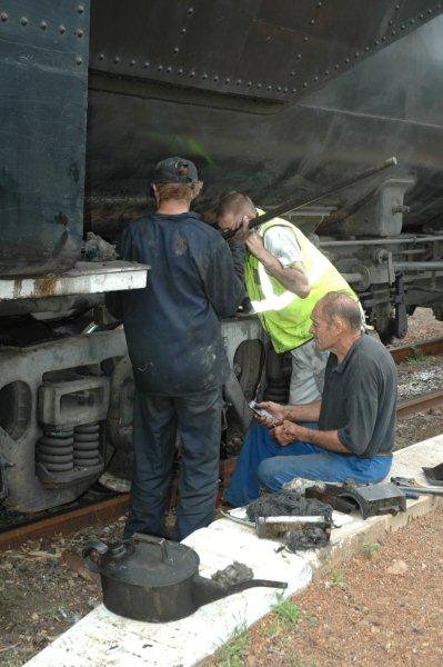

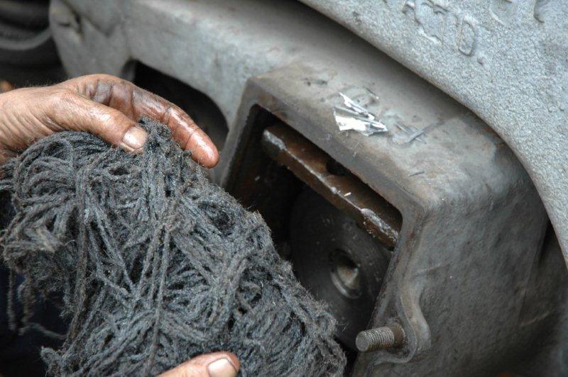

The wool packing is removed to take out the damaged pieces of the white metal bearings. A sliver of this bearing can be seen on the top of the axlebox.
december Cullinan train 2012 032.jpg (78.57 KiB) Viewed 1251 times
